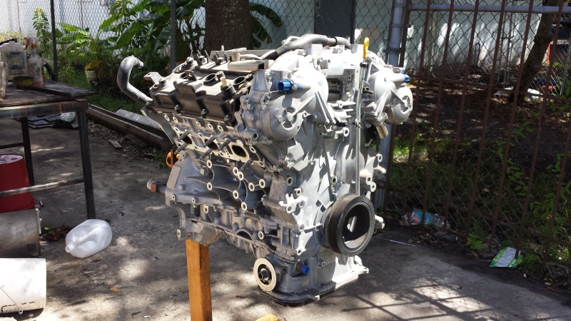

Picked up this baby today
let the fun begin

Whats the plan?

I'm thinkin just slowly build it for fun and put a 37VHR crank in it, forged internals while I'm already in there, some aggressive cams, springs, retainers etc.etc. Gonna try and get my hands on a GTR intake manifold which ill try to bore out and fit dual 09 maxima throttle bodies along with proper sized piping and MAF housings of course. Ill put my PPE headers on it when the time to swap comes around, might go boost by means of a BP style big single, still debating though, no rush at all though. Itll be set up for E85 so ill up the fuel system components for the extra flow needed for E85. Any suggestions are more than welcome

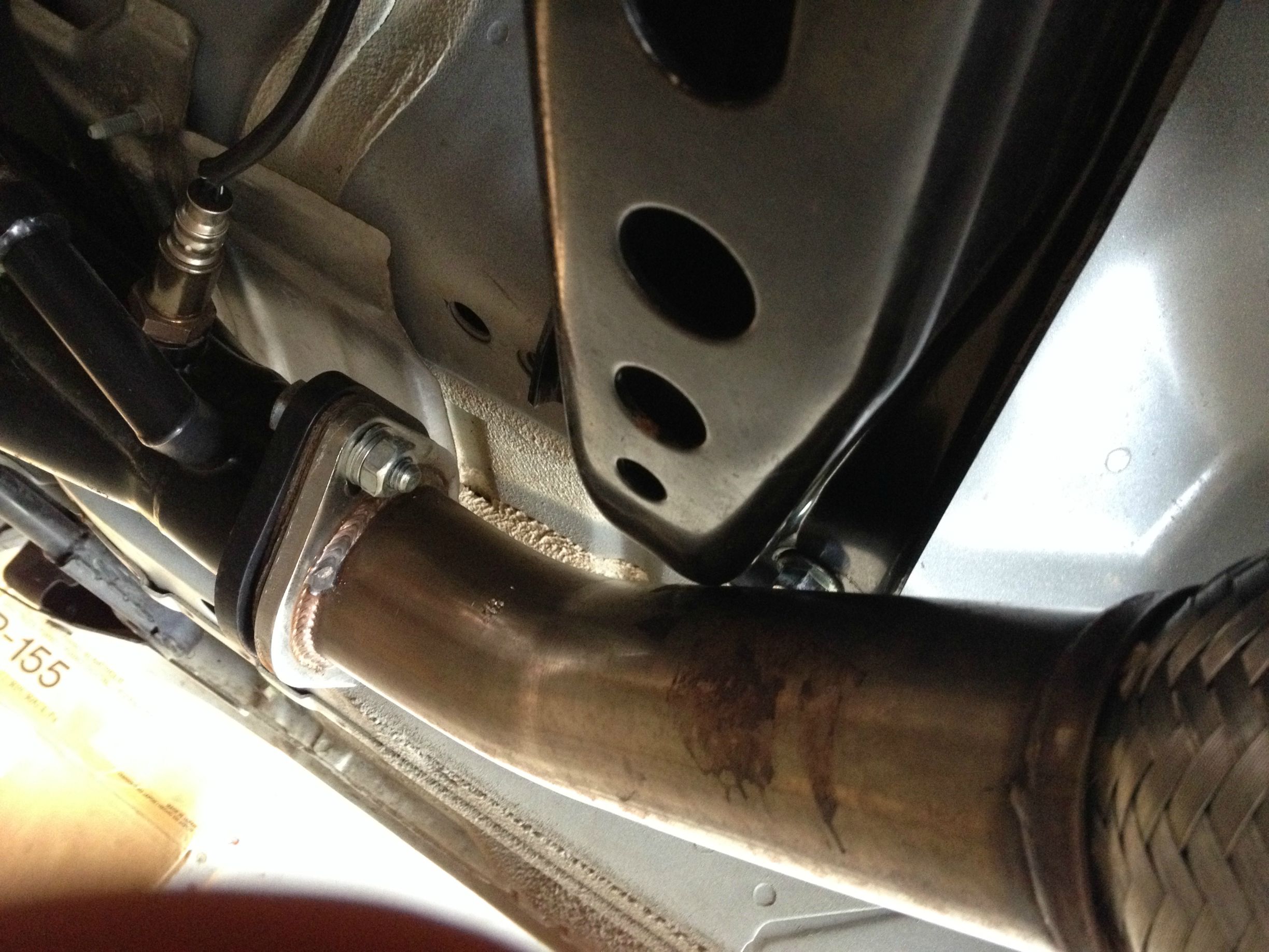

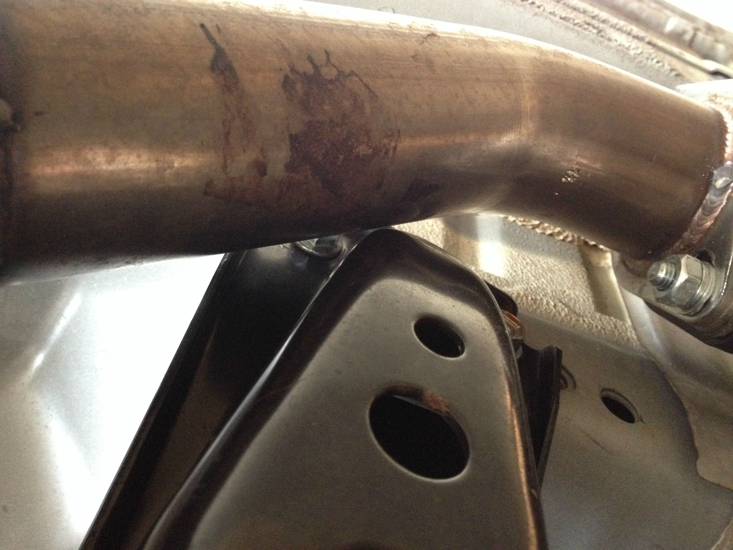

Finally swapped out my POS fitting Motordyne XYZ pipe.
This was all the clearance I had with stacking 3 gaskets per side.

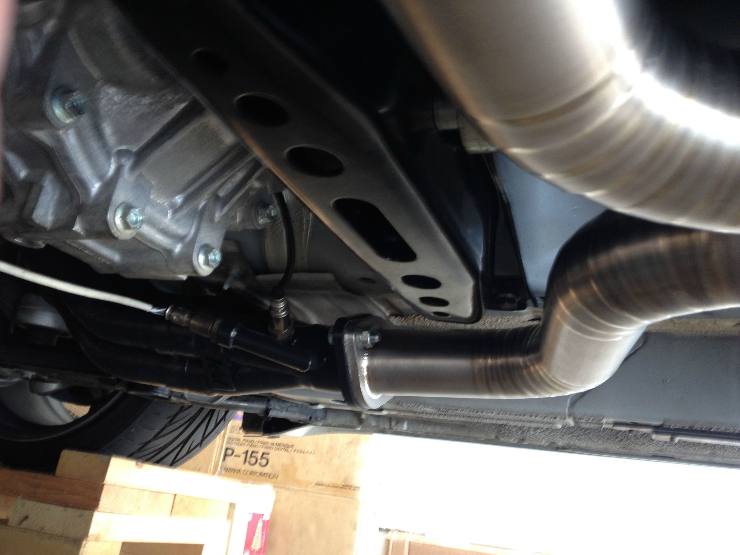

Here's the fitment with new pipe.

Was the short-length issue from the XYZ pipe or the PPE headers or both? It seems only those with the headers seem to have issues. Also, is that a titanium y-pipe?
Old Oct 4, 2013 | 03:45 PM
  #1275
secwind's Avatar
secwind
Joined: Sep 2009
Posts: 419
From: Chicago
I think it's a bit of both. XYZ pipe is very close to the tranny brace to begin with.
Yup, that's Tomei Y Pipe. It's also length adjustable to some extent to compensate the short-length issue.

I posted a gallery here.
http://imgur.com/a/cpXLb
Only problem with Tomei is the inlet diameter causing some rasp and hiss.
60.5mm (2.38") to 70.5mm (2.78")
I will have to live with the extra rasp/hiss until I can find a 2.5" to 3" that fit better than XYZ.
