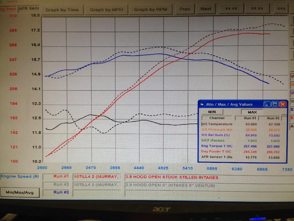

Lol you guys are going to laugh. ****ing got an hour of the way home and bobby calls me to tell me I left my laptop and phone charger at the shop. So I'll have to get it tomorrow hopefully. Anyways, I don't have any videos because I loaded them ontop my laptop.
However I have this picture of the gains/dyno graph of the before/after.
Came in and threw it on dyno with stillen intakes. Hit 285/257 consistently (again, power drop expected with 3.9 final drive)
After hours and hours of tweaking/tuning I left out of there with 299/267 consistent runs.
I am very happy. But this absolutely can't be done at all without towing your car to the tuner, or doing the scaling/tuning yourself (for the people who may see this thread and not be aware)
Anyways, I apologize for leaving my laptop like a dumbass, so no videos yet, but here is the picture of both graphs overlapped.

14hp and 10 tq!!! Congrats on the gains!
