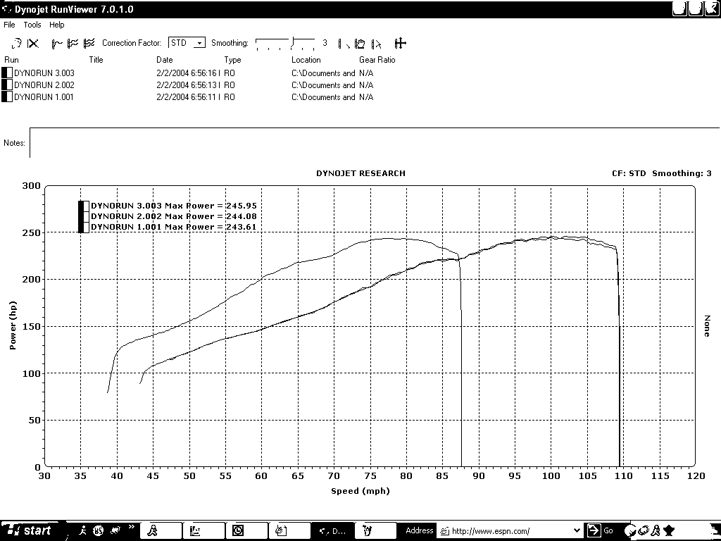

I guess they are dynojet dynos? I need to download the program to view them, so I'll try that one first.
Old Feb 2, 2004 | 03:10 PM
350zdanny's Avatar
350zdanny
Posts: 1,023
From: Central Jersey
here are the three plots.. I attached it in monochrome but you get the picture. For some reason your shop did 2 pulls in 4th gear and 1 in third it looks like.
I used STD correction instead of SAE on these plots in addition to smoothing of 3 instead of 5.
Dan

I appreciate you posting those up for me. Yeah, 1 run was done in 3rd and the other 2 in 4th. Anyways... the car feels great to me, I think with a slight retune of the ecu by fisherspeed or technosquare I will see some nice gains. I am also doing the kinetix intake plenum when it becomes available and then hopefully a reflash.

Not sure, but i'm guessing the gears have to do with the low #'s... 5th gear is the 1:1 ratio and is where we normally dyno at.
Old Feb 2, 2004 | 05:27 PM
350zdanny's Avatar
350zdanny
Posts: 1,023
How much do you think that would affect the numbers? The ratio in 4th is like 1.261 or something.
You'll also notice from the graph that he hits the same power peak in 3rd gear as he does in 4th.
