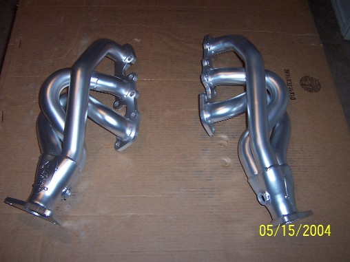

I just had my stillen headers installed 2 weeks ago. They have prven gains and the quality is 2nd to none. Of course I will be biased because I own them but before I bought them I saw a pair next to some Nismo headers and some Borla headers. The stillen just looked more sturdy, real clean welds, overal good quality. I didn't see the reason why I should pay 300 more for the Nismo headers when the stillen ones looked better. And I felt that the quality in the headers was enough that it was worth to pay more for them than save on the Borla headers.
Also, for those that believe installing headers is a do it at home thing. Think again. Everywhere I went said it was at least a 6 hour job. Nissan and some other race shops (Jotech) said it was an 8 hour job. I finally went to 350zforums.org and they installed them at the best price. I was there for the instalation and it is a b*tch. If you don't have a lift it is going to be extremely dificult. The alternator bracket and the surounding housing had to be removed. The intake had to be removed. Hoses rerouted. Lots of work. As for the rest of the exhuast, piece of cake. But the headers are difficult.
