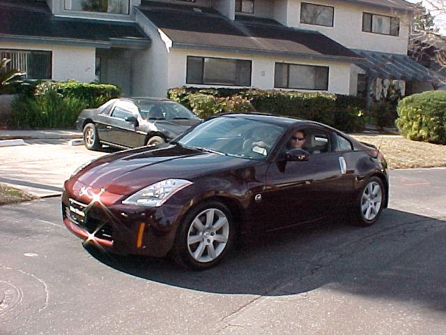

Just wanted to wish my Brickyard 350z happy trails. Turned her in today, signed the release statement and took my check. Hard to see her go but, after being to hell and back during the past 16 months, it was the wise thing to do.
I turned her in with 18,754 miles. My LL milage was set at 16,954 - so I drove her for a while on the "free" miles. But hey, Nissan dragged their feet till I demanded last week that they were taking too long for the buyback.
Any ways - I will contiune to hang around. I'm curious as to the outcome as the problem continues.
I've already started working on my 1983 280zx Turbo - so I'm not leaving the family. Just going to hang out with a "older" woman....
Good luck guys and be careful!!!!!!
Here's a picture on the day I brought her home - had I known......
