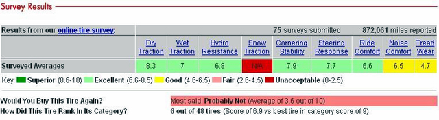

Originally posted by ChinaClipper
The RE040 was NOT designed specifically for the 350Z - it was already available on other cars as OEM equipment. The RE040 was produced in tire sizes specifically for the Z at Nissans request. The RE040 sizes on your Z were not available before the Z appeared.
Yes - the RE040 has been available for years now for various models in the Audi lineup, especially the S4 and RS models in Europe and the US. The new Mazda RX-8 has RE040s also. BTW, you can read the feedback from dissatisfied Audi owners who had RE040s also on the Tirerack website -- same complaints about crappy performance! Duh!
Have you priced RE040s on TireRack? I would not call them cheap! They are priced at the same price point as the S-03s now, but when they first appeared on the Tirerack list last summer, they were higher priced - just below the most expensive Michelin Pilot Sports. None of the tires for our cars are cheap. Sure, some tires are cheaper than other tires, but none are "cheap"! I would say that more correctly, some tires are better suited to the setup and performance & wear characteristics of 350Zs than other more preferable tires. CHEAP tires like Kumhos and Coopers are not yet available in sizes for our cars.
This tire is absolute crap and CC, who IS my impeccable source, is absolutely on target on the price, they were well over $170 a tire for our cars, despite their miserable record. If you want it straight from the owners of these tires, starting in 2000(yes 2000!), read the customer reviews at Tire Rack, there are dozens of terrible reviews. I read about them before my pre-order car was delivered and tried to get them changed to Pilot Sport A/Ss before I took delivery, but my order got lost in the dealership database and was never forwarded to my salesman. After I took delivery, I was immediately aware of their shortcomings. Harsh ride, bounce over some road surfaces and slick as glass under 50 degree weather. Audi issued a letter to S4 owners cautioning them to not use the tires in any snow whatsoever. This is from an S4 owner in their review on Tire Rack.
The 040s are poor tires, period, and Nissan knew it when they were chosen for OE equipment and as CC points out, THEY ARE NOT CHEAP! That is the strangest factor of all in their being chosen, baffling/frustrating/and simply stupid, IMO.
Boomer
