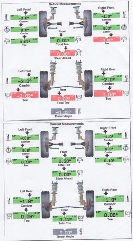

Hi Folks,
Here is an update to a previous posting. I had hoped to meet the Nissan engineer last Friday at Regal Auto Plaza but the Service Manager decided that they had enough to do on another 350Z without adding mine to the mix. Anyway, he said that they had updated specs for the alignment and I had it done this afternoon.
I spoke with the technician who worked with the engineer before and after the alignment and here is what he said, as best as I can remember through the senior moments.
The original specs for the alignment adjustment were in millimeters (mm) from Nissan. They have Hunter equipment and the specs had to be converted from mm to degrees. Several of the measurements were computed incorrectly. When the engineer who designed the suspension looked at the other car on Friday, he positioned the car, pick a tread block and measured from one wheel to the other and immediately said the alignment was wrong. He worked out the corrected parameters for the alignment and re-aligned the car. The service guys I talked to were very impressed with him.
Anyway, before the technician started I asked for a prinout of the before and after measurements. I scanned it in and hopefully it will show up with this post. I might have to make it even smaller but I'd like you to be able to read it.
The technician said that the major change was to set the toe to the maximum, 0.20 degrees. He was told that this had been the original spec which was converted wrong. I asked about the adjustments in the rear and he said they were minor even out of spec as they were.
The car drives even better than before and I don't feel that I have to work to keep the car from going right. I love the car and don't plan to ditch it. I've decided to get some stock in Bridgestone since I might as well get back some of the money I put out every year for tires if this doesn't work. My dealer sounds much better than the one's some of you have. Regal is also a Mercedes dealer and they are very good at customer service.
Good luck with your cars.
