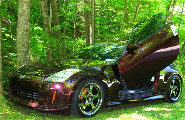

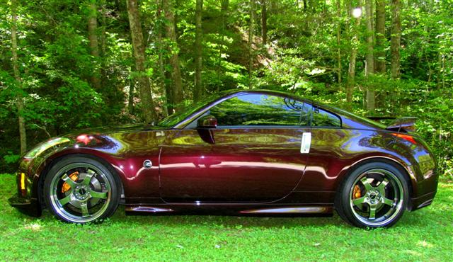

Well guys, I was one of the skeptical many who said that they would hold off on getting this recall work done unless I had a problem. I got my recall notice way back in April and stuck it in a drawer.
I had to break it out this week. When I fill my tank up, fuel LEAKS ALL OVER THE GROUND!
I will be calling the dealer this week to see about getting the work done. I have a Borla exhaust and hopefully they will be able to deal with that without too much trouble. Otherwise, that area of my car is all stock (other than my wheels and tires).
I sort of know the owner of the dealership. He saw my car and loved what I had done to it. He had me give him an entire "tour" of all my mods. I am going to give him a call beforehand to let him know how concerned I am over this work and ask that he put his best man (men) on the job.
I am also going to ask for the old hoses and will take pics for all to see.
I will keep you posted, and as someone else stated, "May the Force be with me!"
