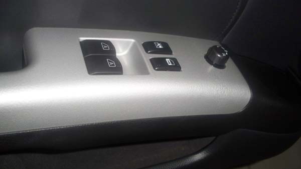

Our Solution.

Old Jun 15, 2009 | 05:09 PM
  #242
Diesel350's Avatar
Diesel350
Posts: 8,378
From: Tampa
Does anyone have instructions on how to pop it off or do you have to take the whole door apart?
Old Jun 15, 2009 | 05:23 PM
  #243
Hraesvelg's Avatar
Hraesvelg
Got Uranium?
Posts: 35,723
Likes: 6
From: The Recliner of Rage
Originally Posted by JDMZ33
Our Solution.
^ I'm going to have to pick those up soon.

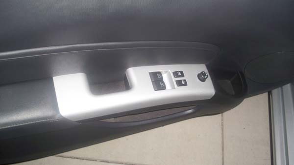

Had the same problem with mulitple scatches on the switch panel.
Just paint them like I did.
Remove the switch assembly, lite sanding, paint (whatever you like), clear coat and re-install.
$15, save you whole lot of money.
you can do the same with eveything else that can be removable.

Default paint it
$15 only

Originally Posted by koz
$15 only
that looks freaking awesome. so you just sanded them down with 400-500 grit sandpaper + clear coar + silver? or did you do something else? someone mentioned a DIY for removing the armrests but i could only find one on the DIY section that had all the pictures taken down. is there another one?
any idea on how to remove the latch for the cubby hole in the center console?
just asking cause i actually went to the stealership today and i was told i was no longer under warranty. the cost of the parts there are $92 each armrest.

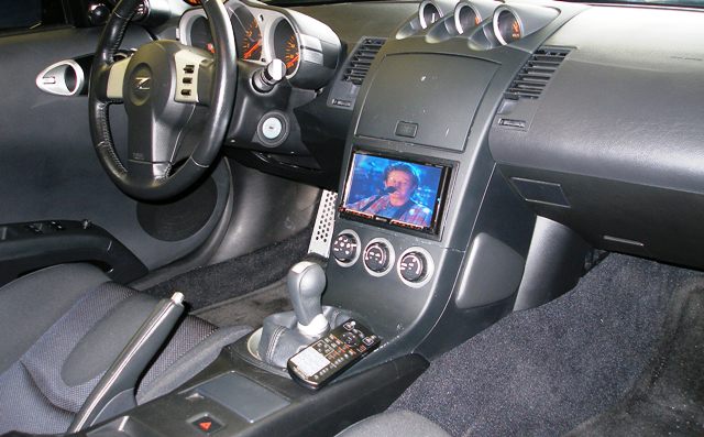

Here's a picture of mine. After doing a double din install, we noticed that the rubber coating on both front center console pieces comes off very easily. You can accidentally rub it too hard with your finger nail and it comes off. You can kind of see the scratches in this picture, and there are more when you see it in person:
