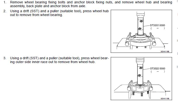

I haven't tried one of the Z's bearings (took it to somebody) but the "normal" way of doing it involves supporting the bearing/hub while pressing out the spindle.
Attached is the FSM instructions.

Go to a local shop with your hub/bearing, pay them and ask if you can watch. You will need a few more tools/adapters along with the press to get the job done.

^^^ Exactly. The guy who did mine took 1/2hr just because he had to rig up some way to support it properly on his press.
