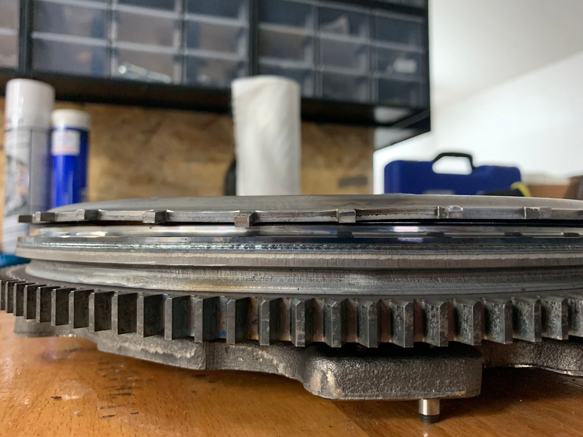

I got the new sensor and replaced it. The car started OK, SES light went away. Driving the car OK. BUT! When I hit 4.000 RPM the problem came back. Rpm needle jumping from 4-7k and the car sputtered and started jerking. Went on the lift again. Took off transmission service plate and started checking ring gear teeth - the ones for CKP sensor. I found 1 bent and 2 slightly bent teeth. I was shocked. DMF was handled carefully from my side so the damage had to exist before I got the new part.
I will present this problem to the dealership where they sold me the DMF. But I suspect I might be in a hole for new DMF. I doubt this can be repaired - heating up and bending teeth back. If the teeth are bent than the plate can also be warped. I would imagine someone dropped the DMF. Dealer will probably claim I damaged it while installing.

Took service plate off on the transmission. Used big wrench on Jesus bolt and started turning the engine, meanwhile inspecting flywheel teeth in especially ring gear teeth. These teeth give a signal to CKP in which position crankshaft is. There are 3 sets of 10 teeth for CKP sensor. 3 times 10 with long spacing in between. Turning the engine I soon discovered a few teeth that were slightly bent. 1 a bit more and 2 a tiny bit. I was shocked! Could this be the issue? Called many mechanincs asking for an advice. They all confirmed this COULD be the issue. Went to Nissan dealer requesting a new part. Box in which dmf arrived was all beat up, crushed and damaged. I suspected someone dropped the box bending the teeth. Nissan said this “complaint” will take 2 months to sort. Wtf?! After a week a wrote a letter to Nissan requesting they speed up the things and stated some law amendments on buying parts. They confirmed a replacement DMF. The cost of new DMF here is roughly 1.400 USD. Waiting another 10 days new DMF arrived. Separately I ordered a set of new driveshaft bolts, pressure cover bolts, flywheel bolts and exhaust gaskets. Waited for those another 10 days. My car was out of service for a month now.
I took tranny of AGAIN! Inspected the DMF and to my shock there weren’t only teeth that were bent. The whole signal ring plate was bent!!! I returned the faulty part and installed new dmf using new fastners and everything - per nissan service manual. Finally everything was set for a test ride. I was nervous as f**ck! Because if this would not work I am in for big bucks not even knowing where to start trouble shooting.

the culprit were actually bent ring teeth.
Word of advice: handle with care the dmf or flywheel. Pay attention to the ring gear. Damage those teeth and you’ll have a lot of (expensive) work and parts on your hands.
Inspect the parts per manual, before you install them.
