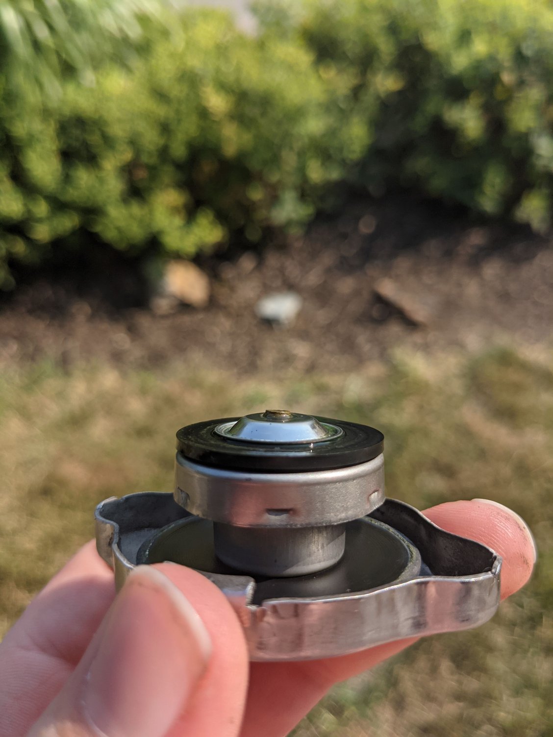

Sorry for the huge *** picture. Got a new radiator cap from Nissan. Looks prety much identical to old cap. I cant see any damage to old cap. The little metal tip(?) in the center of the cap is bent slightly where the new one is straight and stick out just a tiny bit further. Coolant looks fine and the level is good.
Im going to drive if for a bit tonight to see if the temps go up. Any other recommendations?

First, you can't tell if a radiator cap is defective internally. They just stop functioning over time. More importantly, it sounds (and looks) like the radiator itself may be damaged and will need to be repaired or replaced. With 143K on the clock, it's not unexpected. While you can look for a radiator shop in town that can pressure test, clean and repair your OEM radiator, there's always the option of replacing it with a new one. The OEM radiator has plastic end caps around a aluminum core and may not be rebuildable.
If nothing else, good on you for noticing the leak before it could damage your engine.
