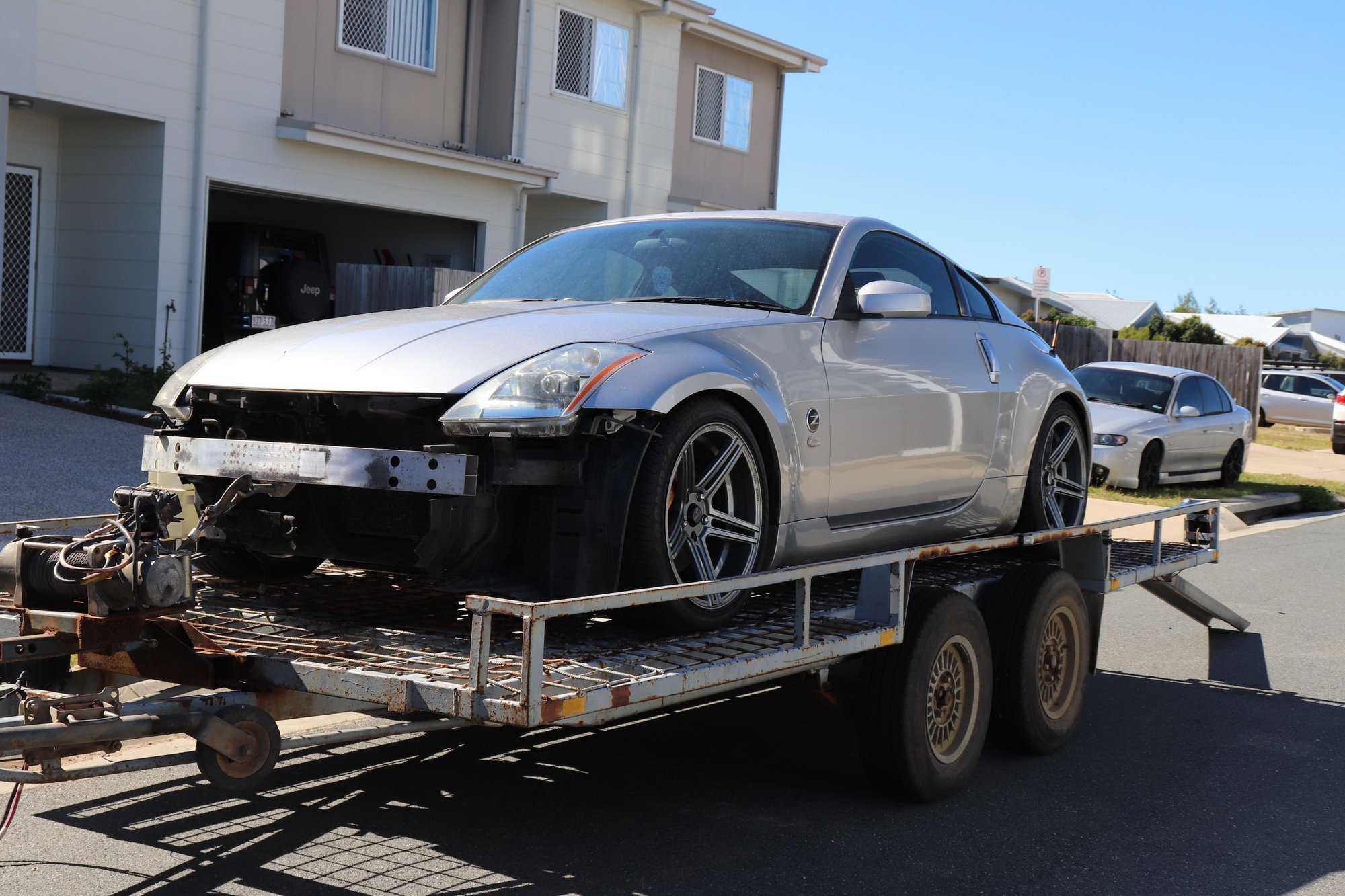

Hey guys so I've been having issues with my '03 350z for a couple of months now, here's a quick overview of what's been happening, sorry for the long read I tried to summarise it.
So I decided to do the timing chain as it was rattling on cold start, I finished replacing timing chains, tensioners, water pump etc. also changed throttle body, accessory belts.
Car started up & ran perfect for a while.. went for a drive and about 11km into it car bogged down & engine died. Wouldn't start for a while then started and ran temporarily as I moved it to a safer place to park it up. Had a mechanic diagnose it as old brittle MAF wiring, changed that & car started up & ran perfectly for a day or so...
This is when the car decided not to start & NATS light goes on solid when key is in ON position, thermo fans turn on full blast.
Scanned the car & got codes relating to ECM not communicating, from there I towed it to the local Nissan dealership. The technicians there spent a few hours here and there diagnosing it and determined it was either ECM or ECM relay. I replaced the relay & it started right up, temporarily.
A couple days later same issue. NATS light solid, thermo fans on full blast.
I then replaced the whole IPDM with a used one from a wreckers as that was $130 compared to $1,500 for a new one from nissan. Car started and ran perfectly, a few times... drove the car home & parked it up to do some other small maintenance & fluid top ups before getting back on the road.
Again.. wont start, NATS light on solid, thermo fans on.
I've tried fiddling with the key, tried the spare key, locked & unlocked heaps of times, disconnected battery & discharged it, I'm also having issue with my OBD scanner not connecting to the car but its a new OBD scanner and I'm unsure if its even compatible.
Going to get a friends OBD scanner which works on his 350z on it in the next few days & see what happens.
possible causes?:
NATS
Fuel Pump
Cam & Crank position sensors?
Bad wiring to IPDM or
bad IPDM itself (unlikely?)
I cannot for the life of me diagnose this properly and it's doing my head in. Anyone able to help?
