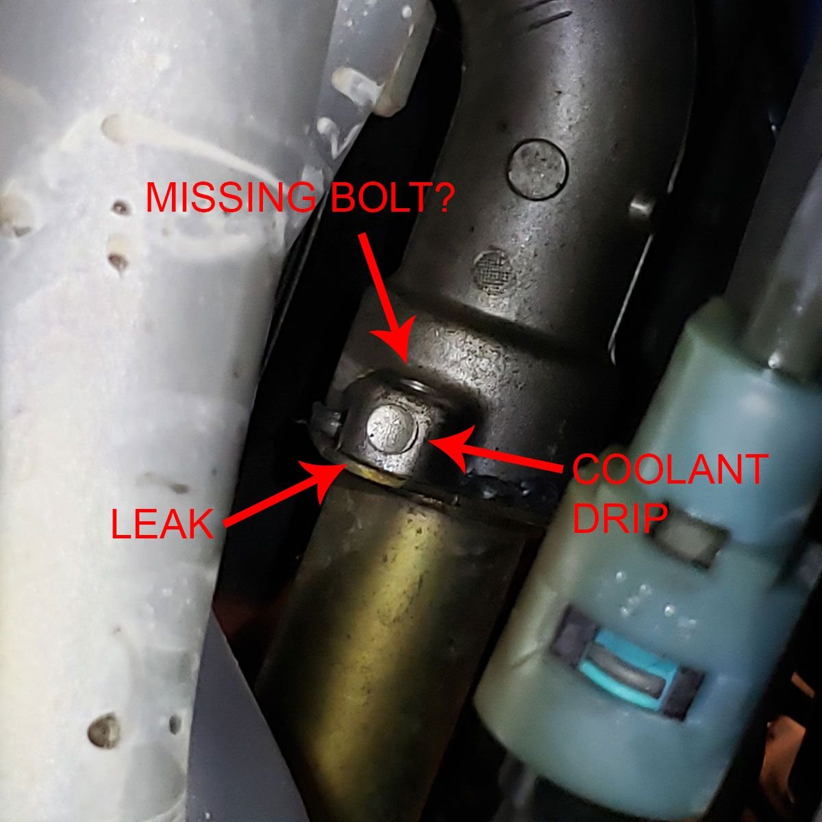

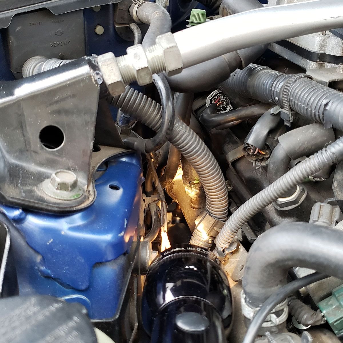

Hey guys, I had my DC headers installed yesterday by a local shop. I drove the car home (about 20min) and everything was fine. Today I drove to the gym (about 10min away), came back home and the second I pulled into my driveway, I saw my temp gauge hit full H. I popped the hood and the coolant reservoir was completely full and bubbling hot, and looked to be leaking a tad out of the cap from the pressure. There was also coolant on the ground and near the wheel well on the same side.
I filled the radiator with distilled water and turned the car on to see where the issue was. After about 90 seconds I saw smoke coming from the left-side headers (looking at the engine bay from the front). There was coolant dripping down onto the headers, causing the smoke.
From what I can tell, the leak is coming from this part pictured below. Any idea's what it could be or what could have happened? Did the shop that installed the headers forget to do something?

I’d bet they removed that coolant pipe to gain access, and may have created a leak there. I’d give them a call or head back.

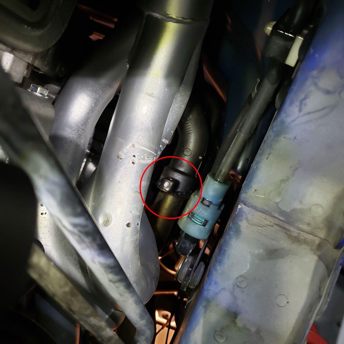

Ok, I jacked up the car and found where the dripping coolant spot. It looks to be between these two pipes.
Is there supposed to be a bolt clamping these together?

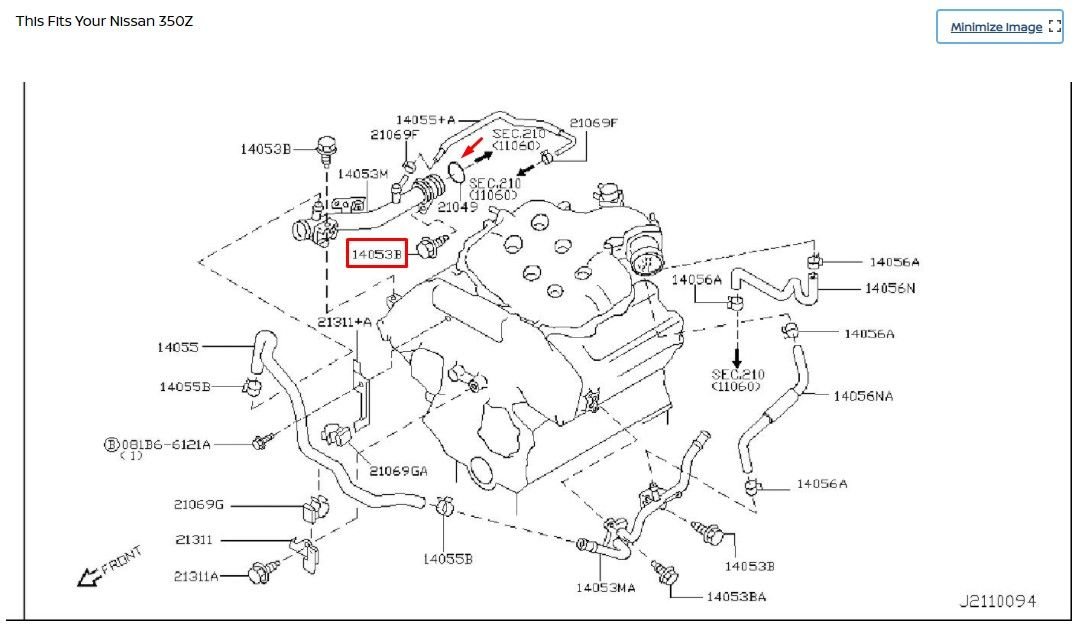

13075-4W00C
Is that missing bolt part number.
https://parts.nissanusa.com/a/Nissan...3.html#14053BA
Old Dec 21, 2021 | 11:14 AM
JRSport018's Avatar
JRSport018
Posts: 474
From: Winchester, CA
@iideadeyeii You are a a gentleman and a scholar. It looks like that is the missing bolt. Do you think I simply get the bolt and screw it in or do I need to get a new O-ring and take it all apart?

I personally would put the bolt in and see if it still leaks before doing all that work. I would assume it would leak once pressure builds up, but not when it is cold/un-pressurized.I wouldn't bring it back to that shop to trust them to bleed it properly.

@iideadeyeii I put the bolt in, cranked it down, and it's still dripping from that spot. Do you think the O-ring is shot or do I need to replace one of those two coolant pipes? Not sure where to go from here.. =/

The bolt hole doesn’t carry coolant, sealing it will be pointless and make further repairs a struggle as the bolt will be harder to come out after being loosened.
The o-ring will need to be changed first, the old one may be installed wrong or just not sealing. Check the o-ring closely as it may have corrosion on it from the aluminum pipe…or rust from the steel pipe, in which case the pipe(s) will need to be cleaned with probably a small screwdriver and some emery cloth or sandpaper. If the pipe is corroded to the point where you can feel pitting, you should smear some light rtv inside before sliding in the other pipe, then leave it overnight to set up before filling.
You do not need to do a coolant flush afterwards, just put back in what you took out and top off with appropriate coolant.
