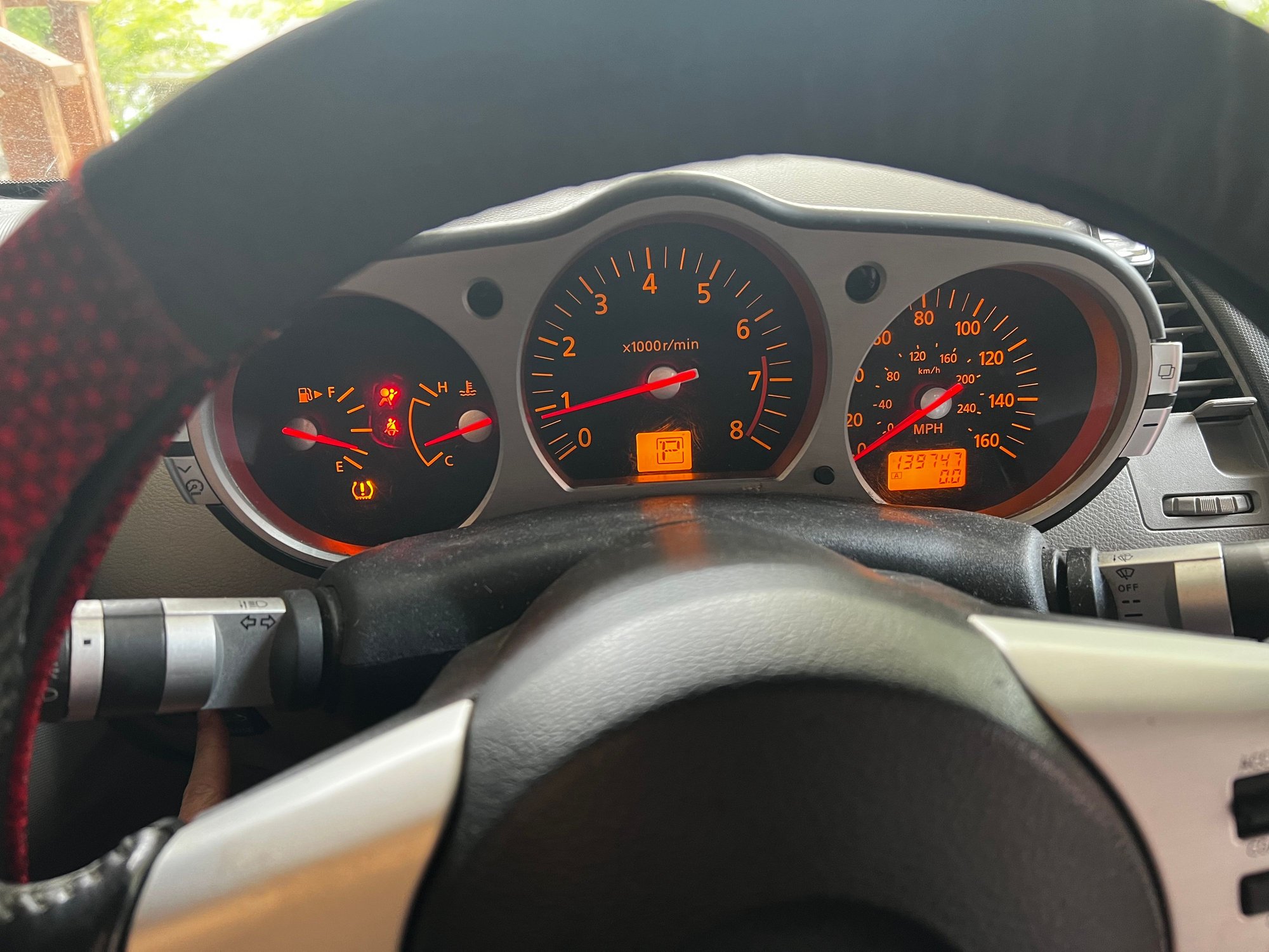

Im having an issue to where my nissan 350 soft top will not even try to lower. no seats moving forward or windows rolling down. the 5th bow motor is good. any ideas or what it could be other than the generic “check fuses”???? thank yall

Does the indicator lamp under the fuel gauge illuminate when you press the switch?
Old Apr 28, 2023 | 12:21 PM
chaycewoolf's Avatar
chaycewoolf
Joined: Apr 2023
Posts: 4
From: Arkansas
Negative
