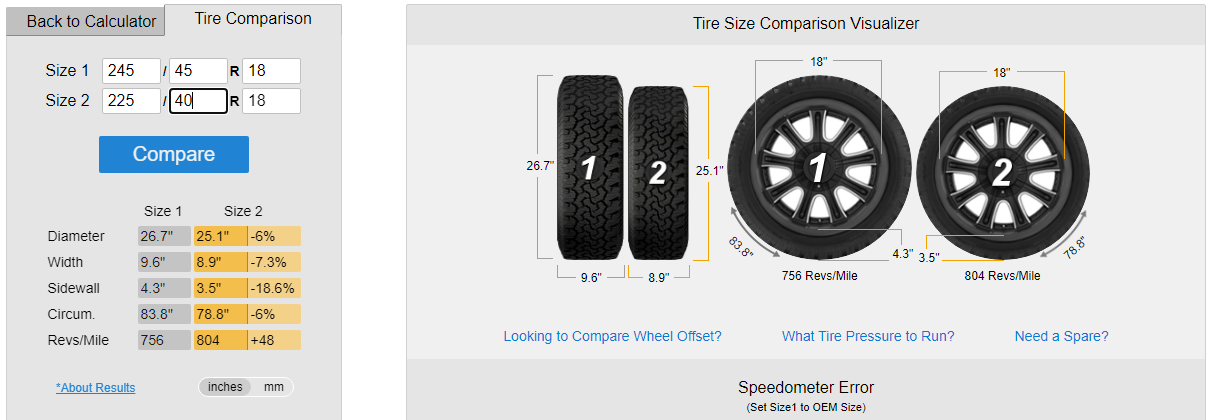

Well, Trav was dead on because therein lay your problem. (I assumed you had a stock setup not this janky weird setup.) You must have TCS or VDC. Said systems are looking for 3% +/- 0.25% delta between front and rear. The 215/35 and 235/45 setup is running some 9.5% delta (about 2.4" delta F/R!). VDC/TCS is triggering because the speed sensors are telling the ECM that the front tires are spinning out (when in reality, they're just running greater than 3.25% more rotations/ft than the rear, hence SLIP/VDC.
Originally Posted by carloz.33
The car originally came with the 17in. stock 7 spoke wheels and 225/50 tires. I still have the old pair from my previous setup so i can throw those on in the front for the meantime. But now the starting issue, if the 18x9 235/45 setup is on the car in the front, how will the car know if it won't start now? Should i try jump starting?
The car doesn't know the tires are that far off until the car is moving so the speed sensors can do their thing.

Forgot to update but the battery was load tested. Replaced the alternator which was the problem car is now running.
As for the wheel/tire setup, i've been wanting to get 215/40 in the front and 235/40 in the rear, which would leave the difference at 2.4% or .6" which should be in the green right? (Front: 24.8" Rear: 25.4"). The original stock tire setup was 225/50r17 all around meaning there was a 0% difference. As for the janky setup it's just what the wheels came with and the tires were good so i haven't bothered replacing tires
