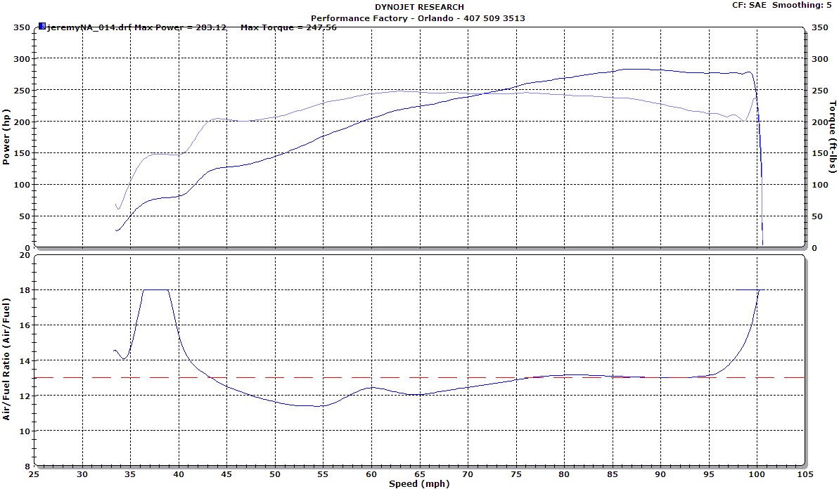

ok, first of all, it started right up!! i am very happy with how it sounds and runs, so WTF, why not break it in on the dyno?? hehehe
here are a couple of the first pulls. this is still stock headers, stock lower runners, stock plenum, stock airbox and tube, mild cams and not tuned. i just did a couple pulls on the dyno to make sure the AFR was safe and took some timing out to be sure...
more to come soon!!!
remember, this is on a dynojet in FL at about 80 degree weather with about two hours of breaking in before hand, this is seriously just the beginning...
Notice how it pulls straight across from 6250 on, i have the rev limiter at 7500 for now...

yeah guys, the motor was very heat soaked, the temps of the coolant stay down pretty well though, just the motor was hot.
i waited about 10 minutes between a pull with the same map and it made 8 more hp.
there is definitely a lot more in it, the heads are fully done btw , i think the car is starving for air though now, i pulled out the k n n filter on back to back runs, on the second run with the filter out, it made 4 more hp with nothing done.
i will be changing it over to a map sensor and speed density so it puts the same fuel settings in every time and doest do a factory off set with the utec.
time to go play some more, i have to tune a few cars today, tomorrow and friday, so i wont have much more time with my car till this weekend
im taking donations on WILD cams and long tube headers where is tomei when i need them??
Old Mar 28, 2007 | 04:08 AM
  #198
Audible Mayhem's Avatar
Audible Mayhem
My350z
iTrader: (48)
Posts: 5,165
From: United States
car weighs in at 2500 without me in it, thats still with stock doors, hood, rear hatch and all glass fully caged...
should go 11s all motor without a doubt
here is the same chart SAE, it puts down about 8 less hp.
i think i will go do some pulls this morning when its a bit colder.
