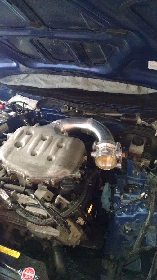

Making more progress. Got the 2nd pipe cut and most of the way welded. The 2nd pic: the test fitting of the TB. Flange and TB both fit. I am going to have to notch a tiny bit out of the hood framing for the hood to shut. Shouldn't be too much though because it almost shuts all the way now. Going out in the garage here in a bit to work on it some more.

Old Feb 8, 2015 | 09:16 AM
  #317
3hree5ive0ero's Avatar
3hree5ive0ero
Retired Admin
iTrader: (95)
Joined: Dec 2000
Posts: 1,337,017,813
Likes: 78
From: Dallas / Chicago
Looking good!

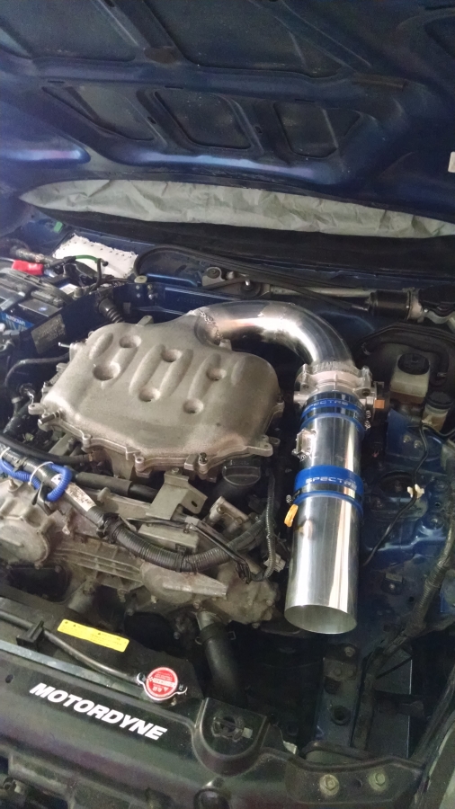

Getting there. Got the flange tached onto the pipe to test fit intake piping. I finally feel like there is light at the end of the tunnel. Also, ordering cams, springs and retainders on Friday.

Old Feb 8, 2015 | 10:48 AM
  #319
The_Assassin's Avatar
The_Assassin
Joined: Aug 2011
Posts: 995
From: coopercity, FL
Nice work man. What cams are you going with?
