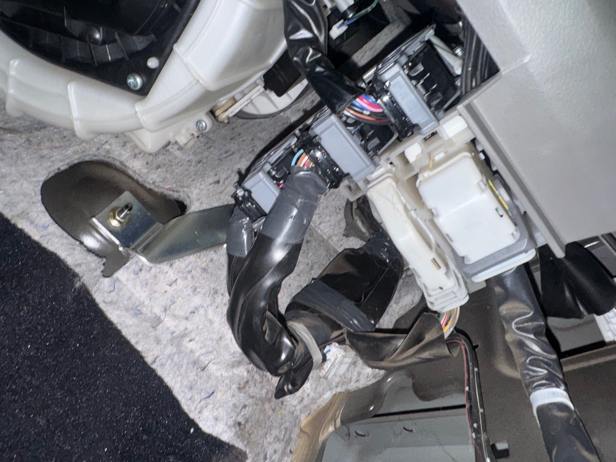

Last wiring to pull, disconnected the three black connector then the white skinny one. All gets pulled out from the cabin.

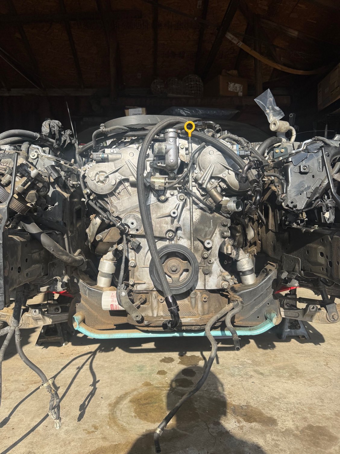

The loom resting over the engine. At this point now, I just need to go underneath and disconnect: braces, exhaust, and driveshaft. Then just pull!
My pressure bolt and fly wheel came in... but my supplier is going to mail out me the throwout bearing for the MT so I have to wait now. I can't close up the motor/MT just yet then. I'm going to wait for it, because I don't want to try to wrestle the bolts into place separately so I rather bolt them up and glide it right into place. Figured it'll be easier.

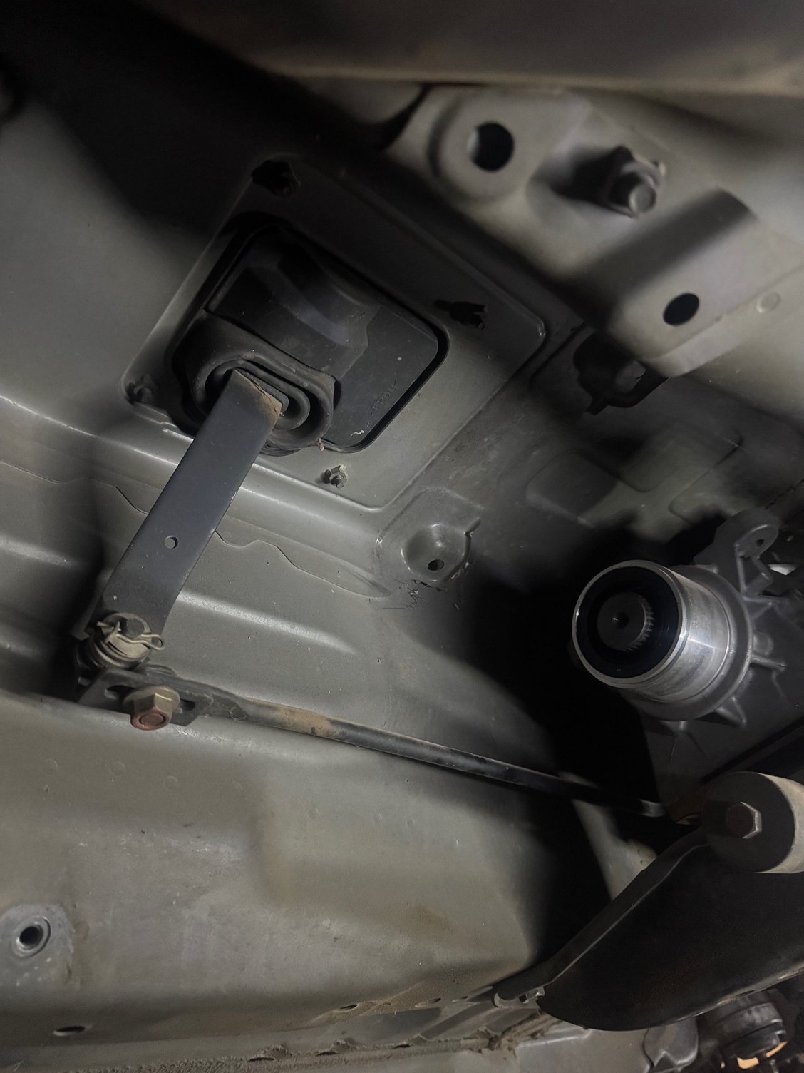

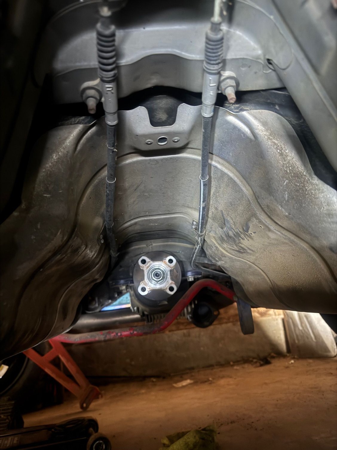

Removed all the braces, exhaust, HFCs and driveshaft.
Now I am fairly sure I just undo these shifter linkage and that's that. Just one nut under the motor mount each and undo the AT braces and out it goes.

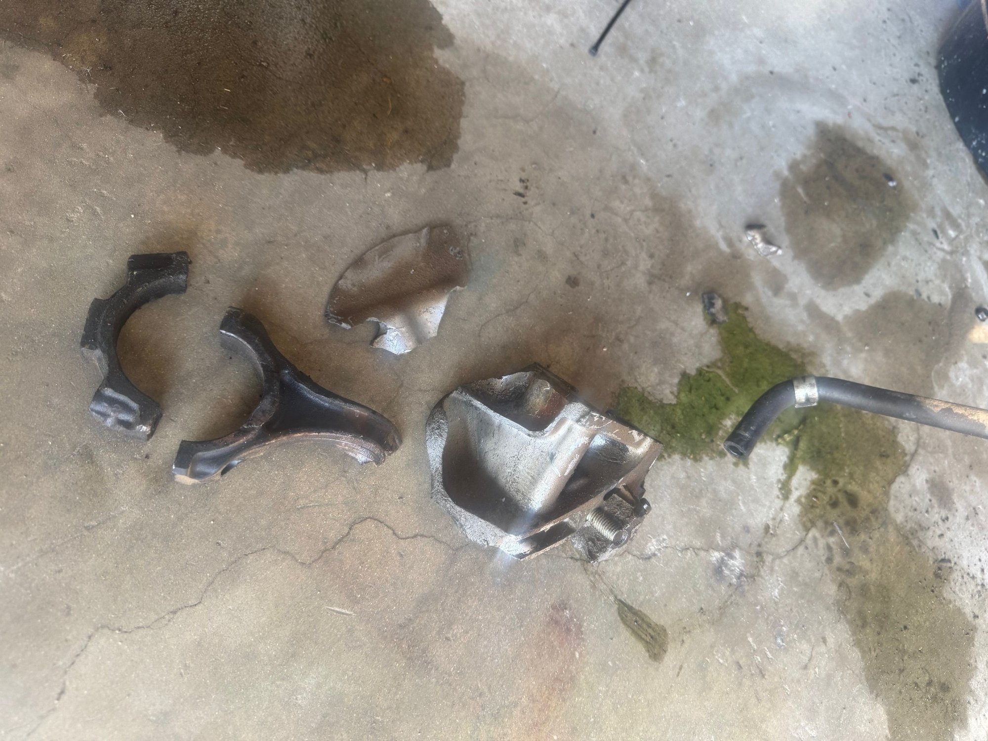

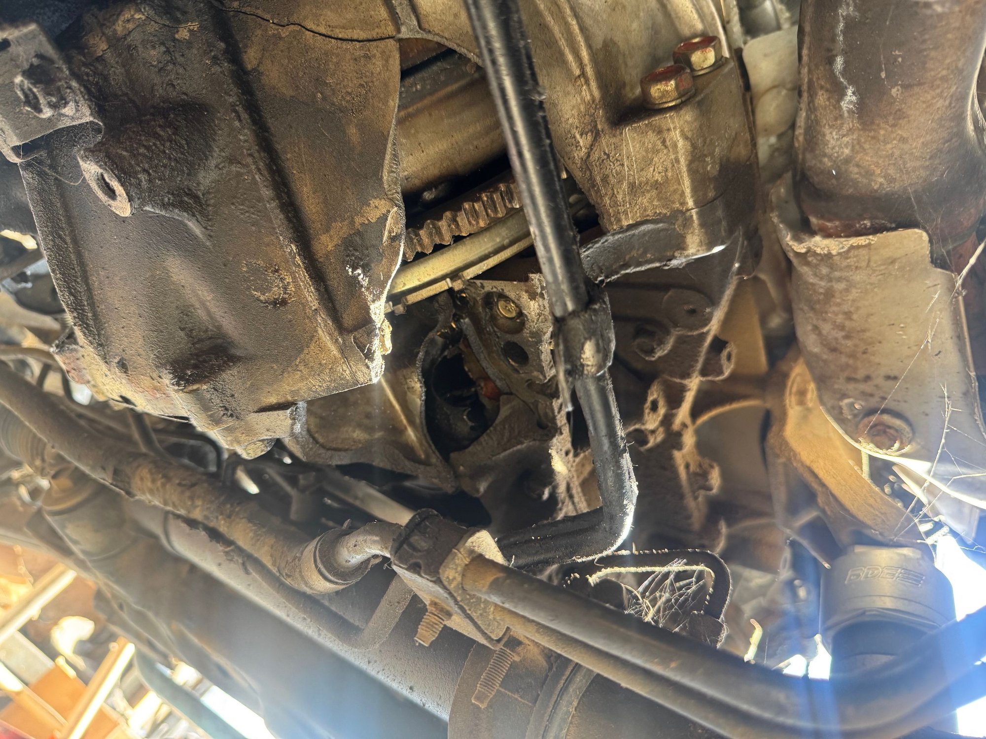

Since I pulled everything out. I did get a better look at the carnage for you guys. The AT bell housing gave out AND the engine block gave out. The starter is on the other side (driver side).
AT had the the same OEM fluids and the engine may have been running low on oil thus commencing a mortal kombat combo move.
