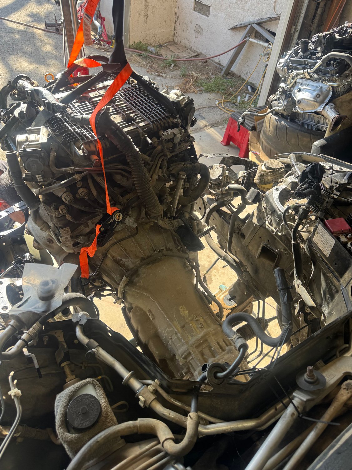

Update:
Removed all the braces, exhaust, HFCs and driveshaft.
Now I am fairly sure I just undo these shifter linkage and that's that. Just one nut under the motor mount each and undo the AT braces and out it goes.
Since I pulled everything out. I did get a better look at the carnage for you guys. The AT bell housing gave out AND the engine block gave out. The starter is on the other side (driver side).
AT had the the same OEM fluids and the engine may have been running low on oil thus commencing a mortal kombat combo move.

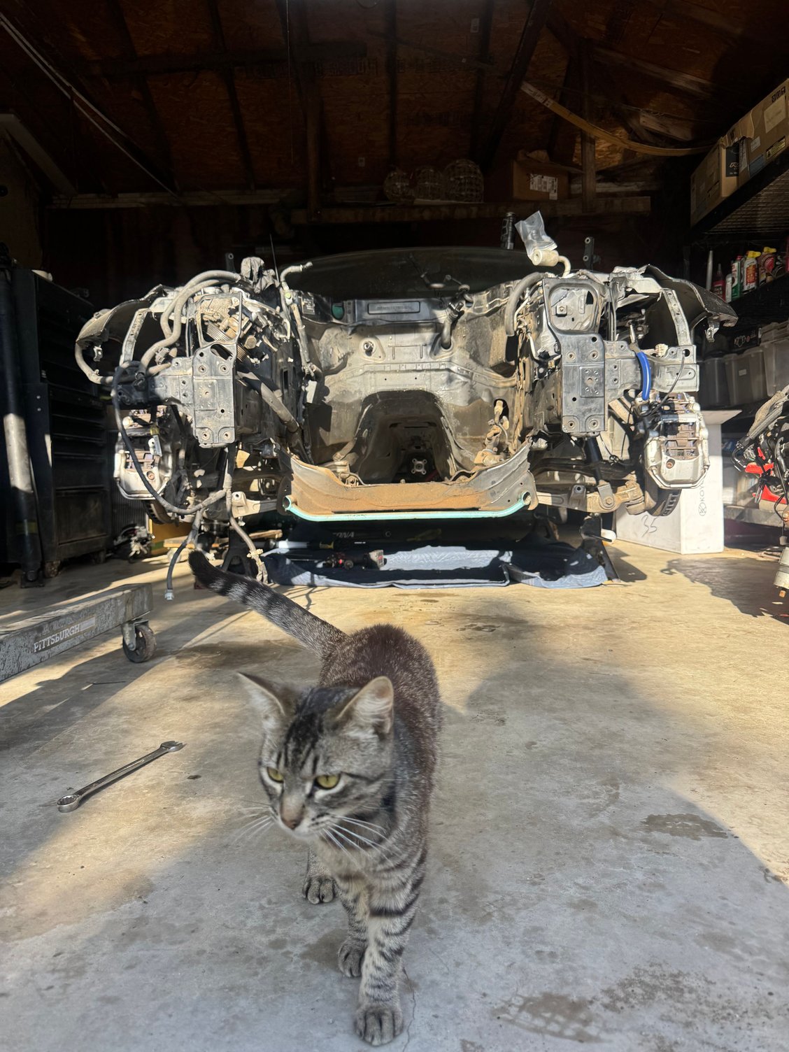

@DarkZ03 You’re correct. I see they made a few models so far, Z being one of them for now.
I finally pulled the engine with the AT out of the chassis for the first time ever.
An empty engine bay. The perfect chance to wipe down the chassis and take measurements for my hypothetical engine.

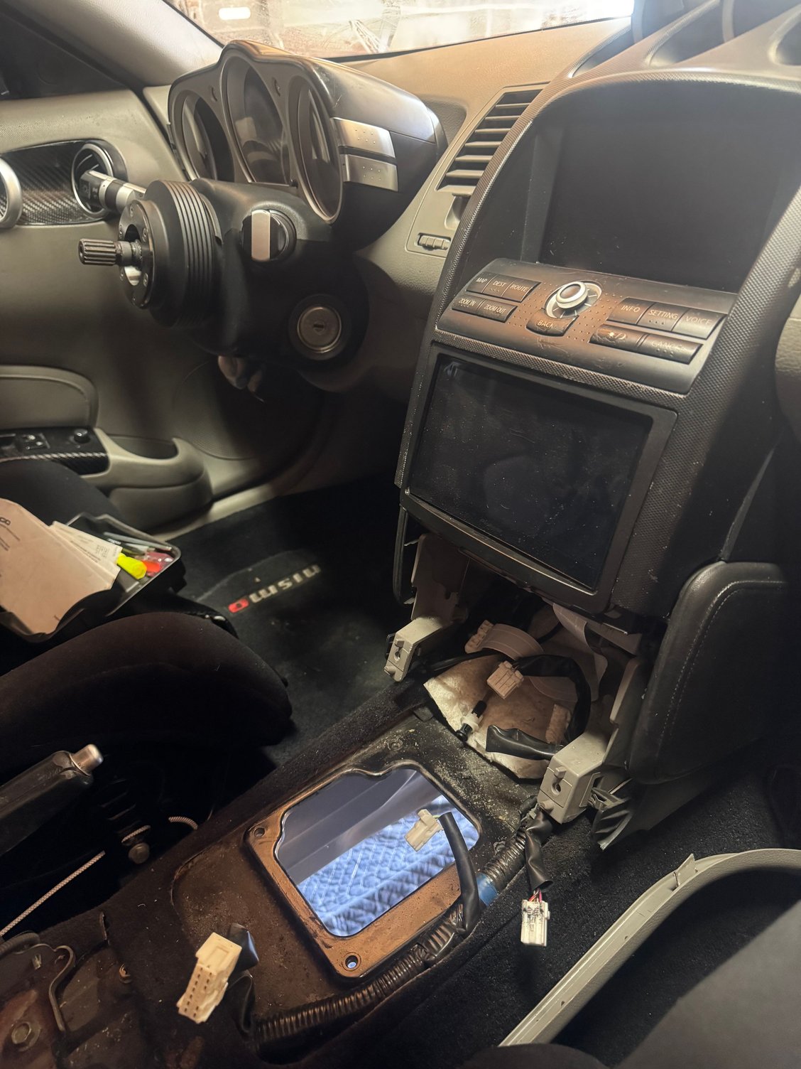

Also removed the shifter. Took some finesse but got it. Just need to enlarge the hole by 1 1/2 inch toward the rear of the car.
Now at this point. All I can do is pre-flight the wiring for the new motor and wipe down the chassis.
Still waiting on my throwout bearing to arrive to pack everything up.
