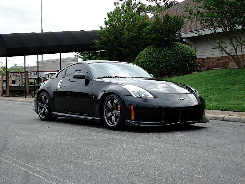

lowered just a little bit...
I like it on the track.. on the road is quite a PITA.
if you keep the settings on the soft side is drivable also on the road.. but be just careful. yes it's an upgrade... but can be done better... the feeling is that those shocks has to much compression control and not enough rebound control. (details.. are good... but not "racing")

Thanks, I love your car looks very clean with the drop
I may only go half a inch because I don't want to tear up my front end.
