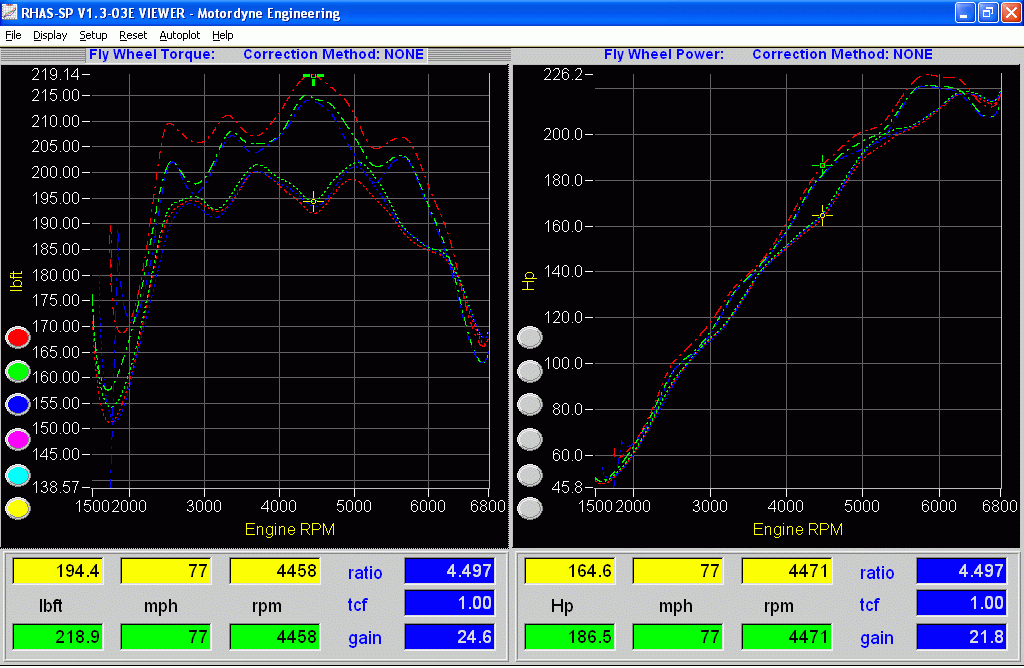

Hi Guys,
Attached is the latest REVUP test with a MREV2 and 5/16" Iso thermal spacer. All pre/post dyno pulls shown.
Indicators are placed at the best pull Vs best pull max HP/TQ delta points.
21.8HP / 24.6TQ.

There are actually several who have the V+ with an MREV2. We just don't hear about them on the board.
I don't think it has been dynod though. In any case the V+ won't be all that much different than a spacer so the overall gains will be very similar to the plot above.
