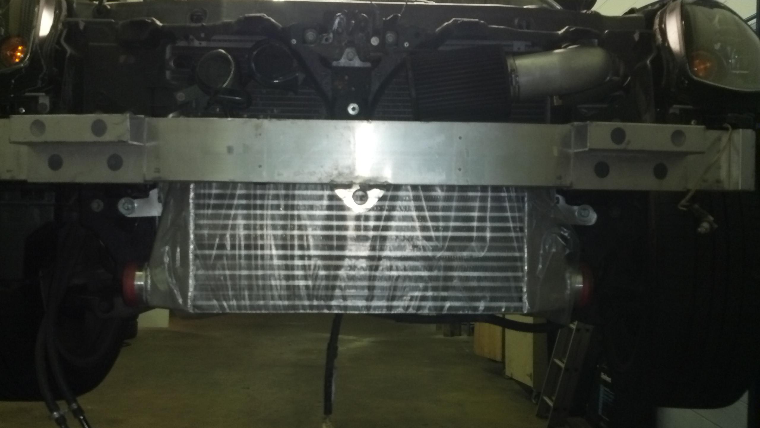

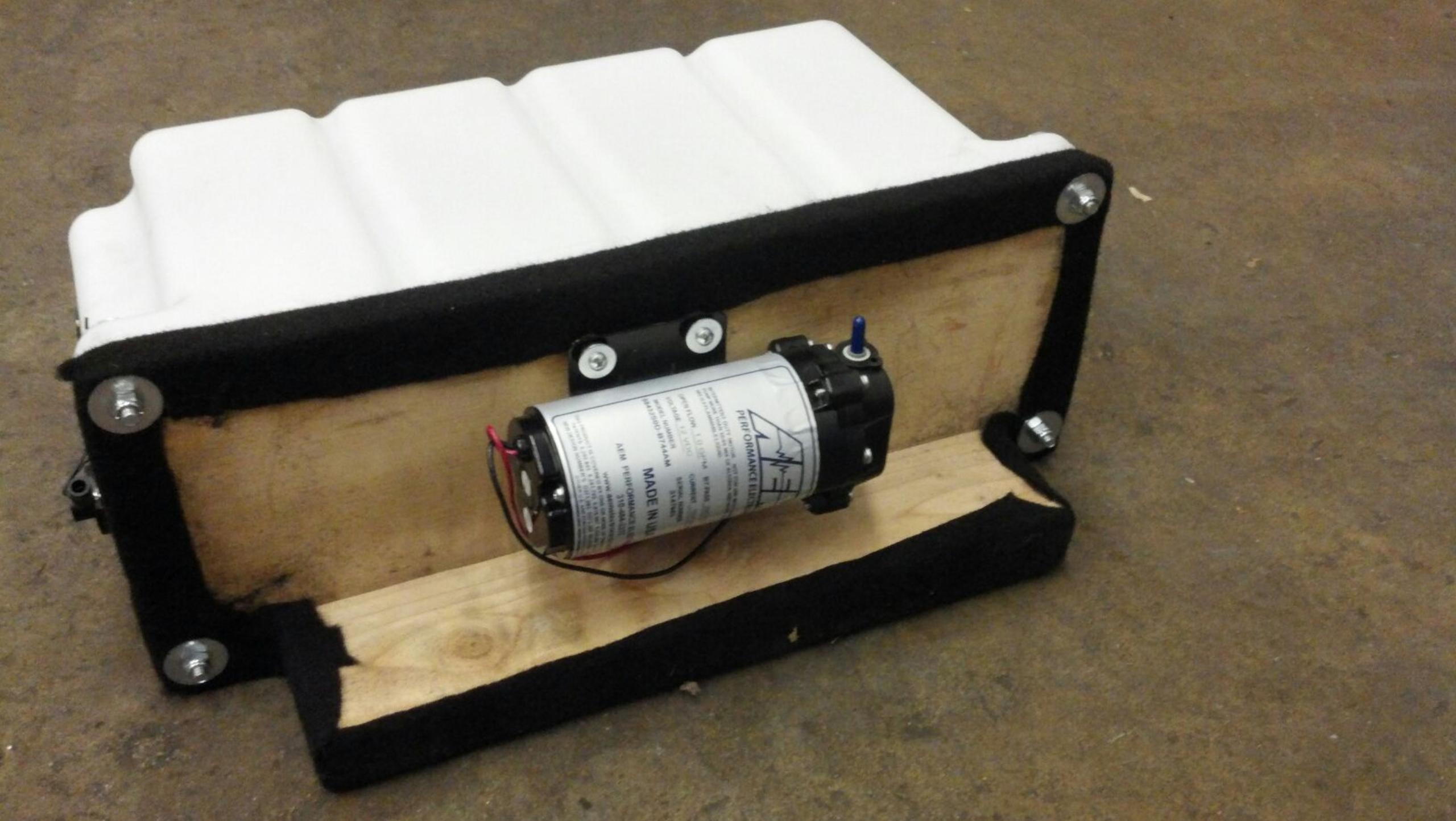

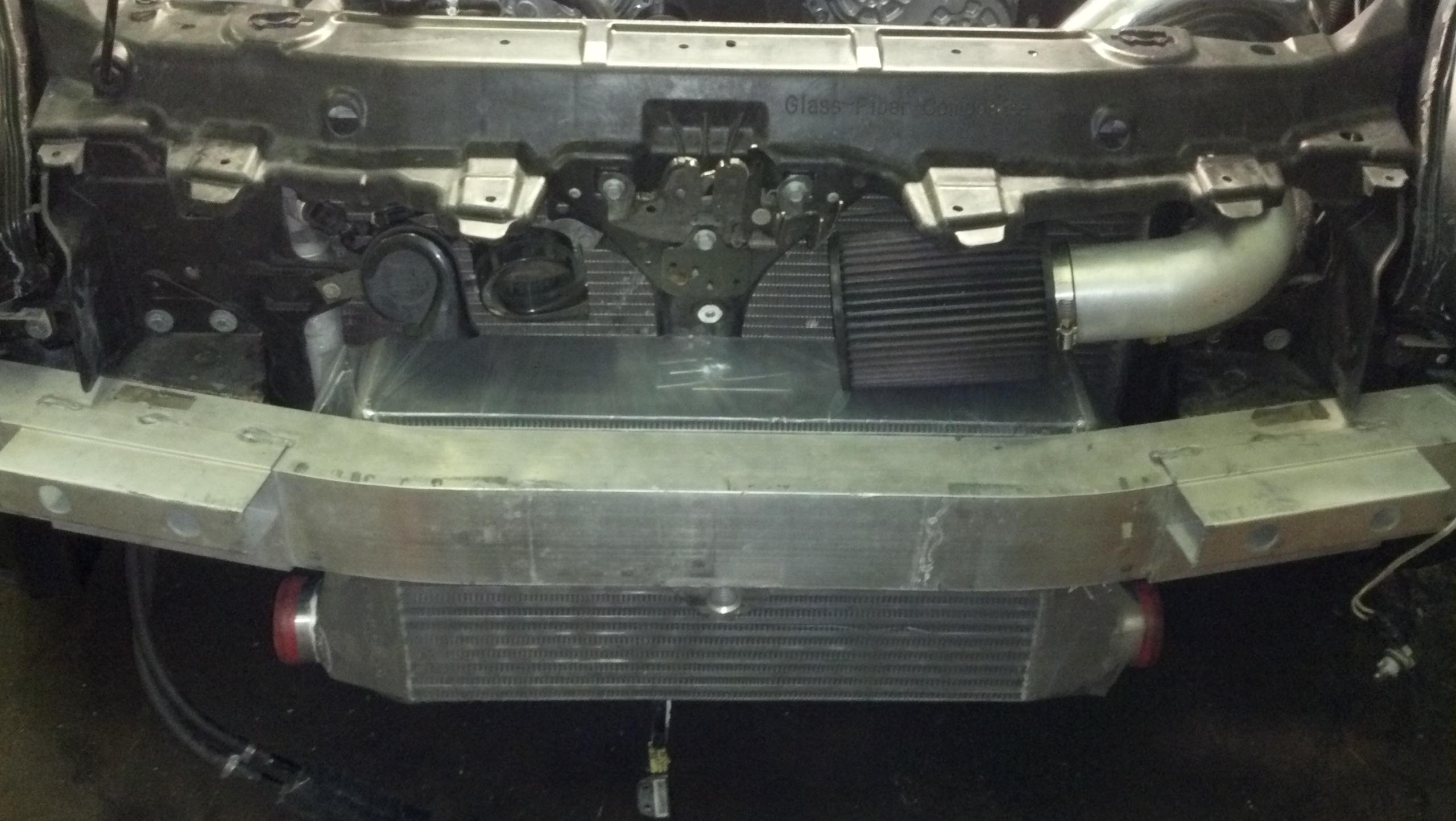

400 gas is 500 on E 6900rpm
your good at 12 psi 928 impeller
Old Dec 6, 2011 | 10:41 AM
  #79
4SHIZZIL's Avatar
4SHIZZIL
Posts: 4,410
Likes: 9
From: NOVA, Richmond, DC, MD, St.L
Thumbs up
1000hp fmic 5 gallon Meth tank and pump set up.
