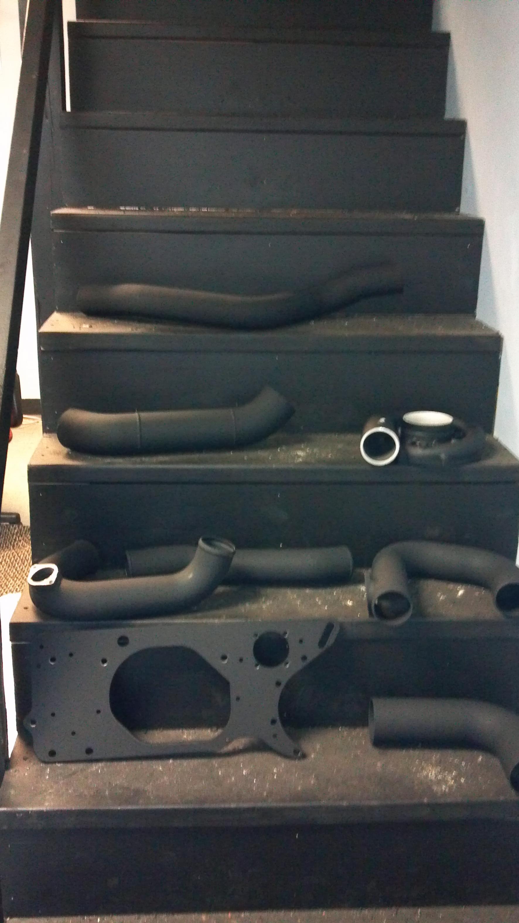

Powdercoating in.... shes being put back together today so hopefully tune on Thursday!
cross your fingers...see the attached pic for:
All SC piping, new 3 inch intake
SC bracket
SC housing
matt, textured, black to match plenums and strut bar.

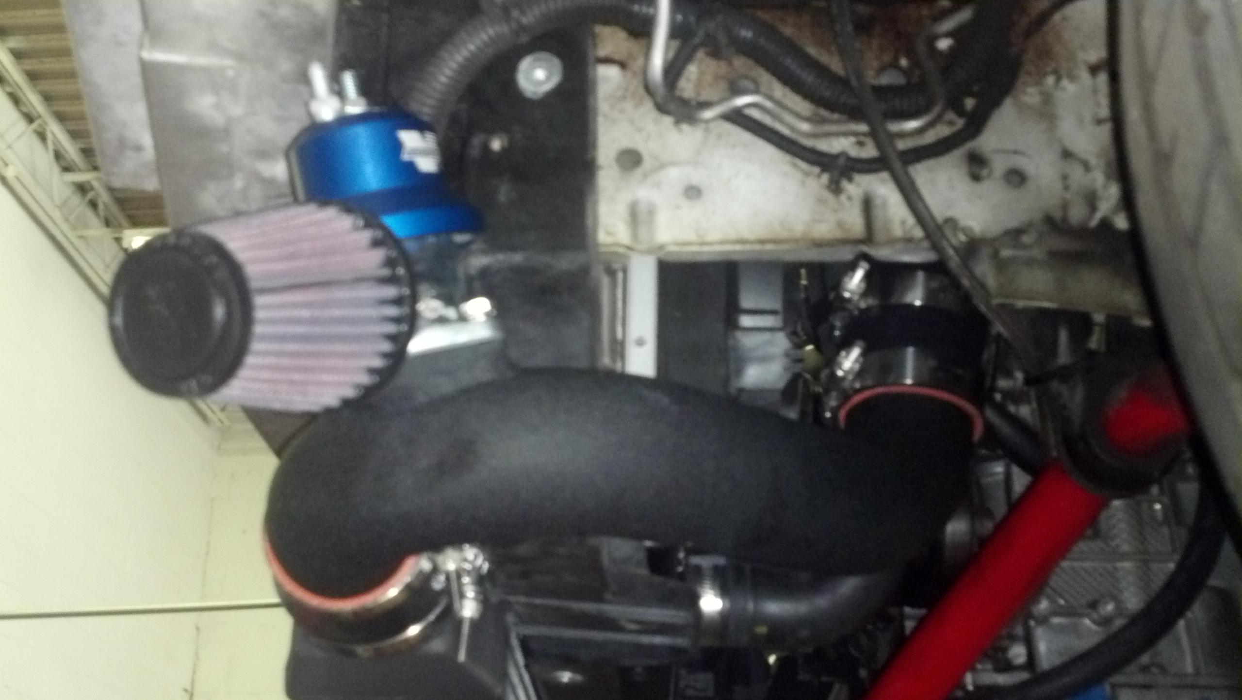

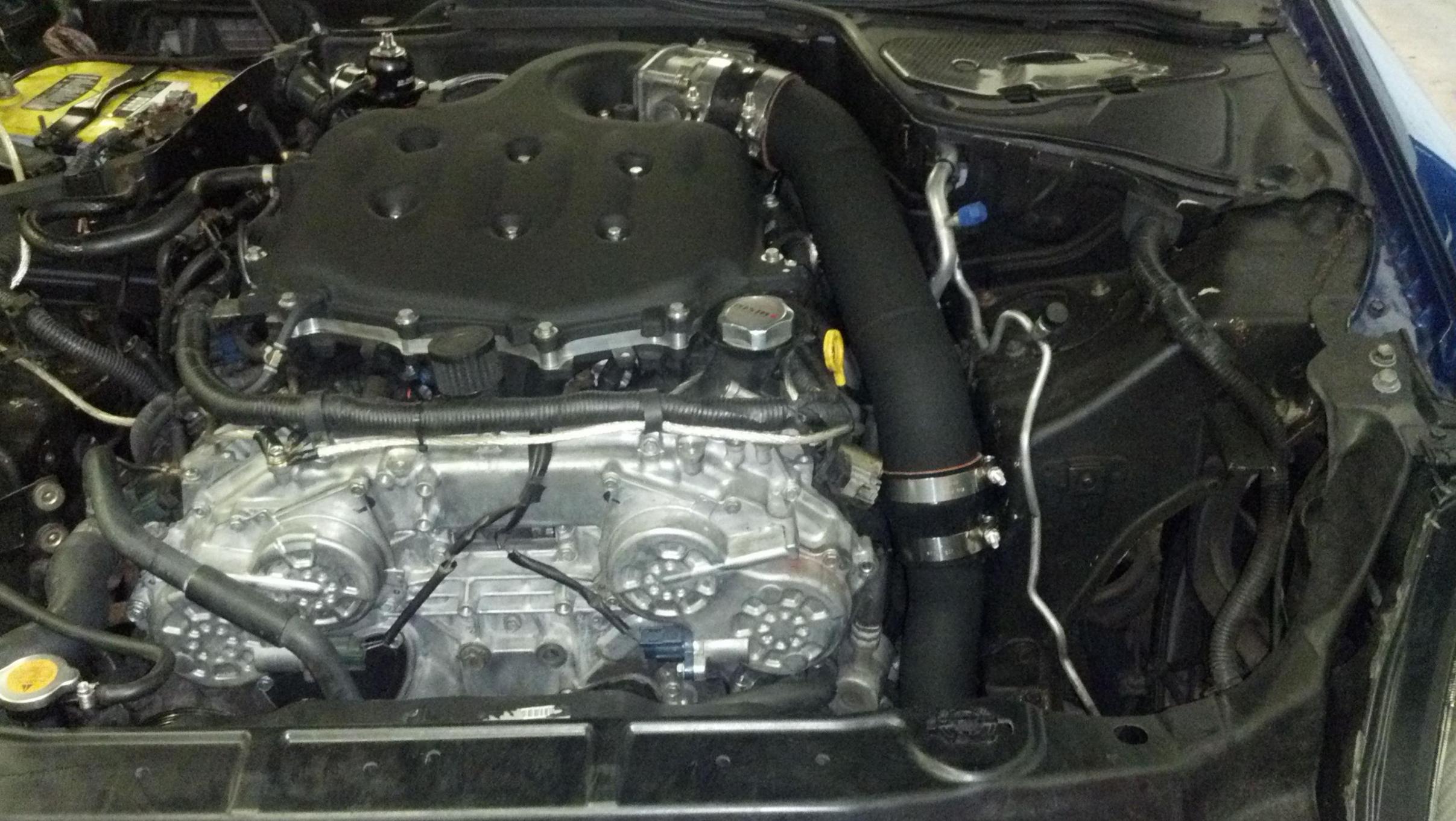

Since the new FMIC is 300HP over the last and I made 22psi with a boost leak (found hole in a pipe) I went stealth... minus the airplane sound. lol
I hit a cynder block about 2 years ago, thats the dent in the up pipe.
Secondary Blow off valve installed to aid in decell pressure relief. Estimated 3.5 psi diff from entry and exit on the FMIC. per vortech.
Attached Thumbnails 560/460 Hills Garage Vortech Beast!-resizedimage951324567547718.jpg   560/460 Hills Garage Vortech Beast!-resizedimage951324567398049.jpg   560/460 Hills Garage Vortech Beast!-2011-12-229510-23-4595250.jpg
