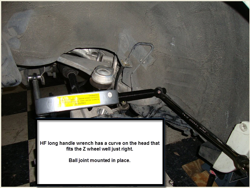

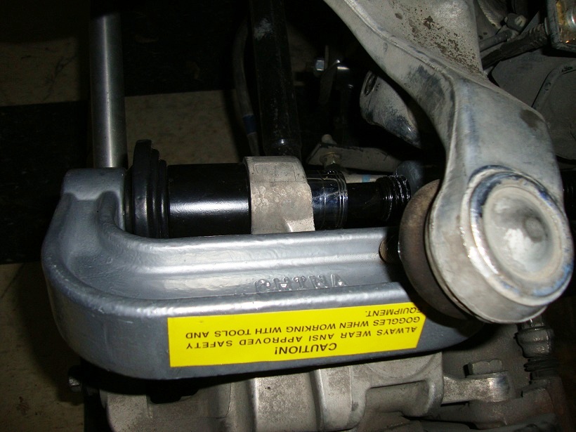

Rear knuckle bushing where shock/coilover attaches:
HF Ball joint tool: ~ $29.99 on sale Item 38335
26mm socket used to remove oem bushing:
Obviously this picture was taken after i took the bushing out to show that the socket fit well.
Mounted up:
I purchased HF long handle wrench set ITEM #47067 and used the 22mm wrench from the set. The beautiful thing about it was the angle the head had and the length for leverage in fighting the bushing out. Having the 22mm wrench made it EASY:
22mm long handle wrench from HF set used to turn da bish:
OEM BUSHING ON ITS WAY OUT ~ FALLING INTO RECEIVING STEEL CUP:
OUT:
However, notice how this side of the rear knuckle is machined FLAT!
Well, the opposite side is NOT flat and is angled at about a 5 degree angle.
~ Sorry, I didn't get a picture of this ~ but I then found a larger piece of steel and cut one side of it at a five degree angle with my chop saw to help line up the ball joint tool STRAIGHT!
Notice how this side is angled at 5 degrees, and how the black receiving cup isn't straight:
I replaced the black steel cup with another larger piece of steel, cut one side at a 5 degree angle and then when i rigged the entire ball joint tool back up everything lined up great and bushing pressed in easy on the first time!
Steel needed to install the whiteline bushing in:
To install this whiteline W62535 bushing you need to go to a local steel yard and get a Overal diameter 1.5" DOM STEEL round stock with a .083 wall.
That results in a 1.5" - .083" - .083" = 1.33" Inner diameter that fits over the W62535 rear shock mount bushing perfectly:
New Whiteline P/N W62535 bushing installed:
-J
