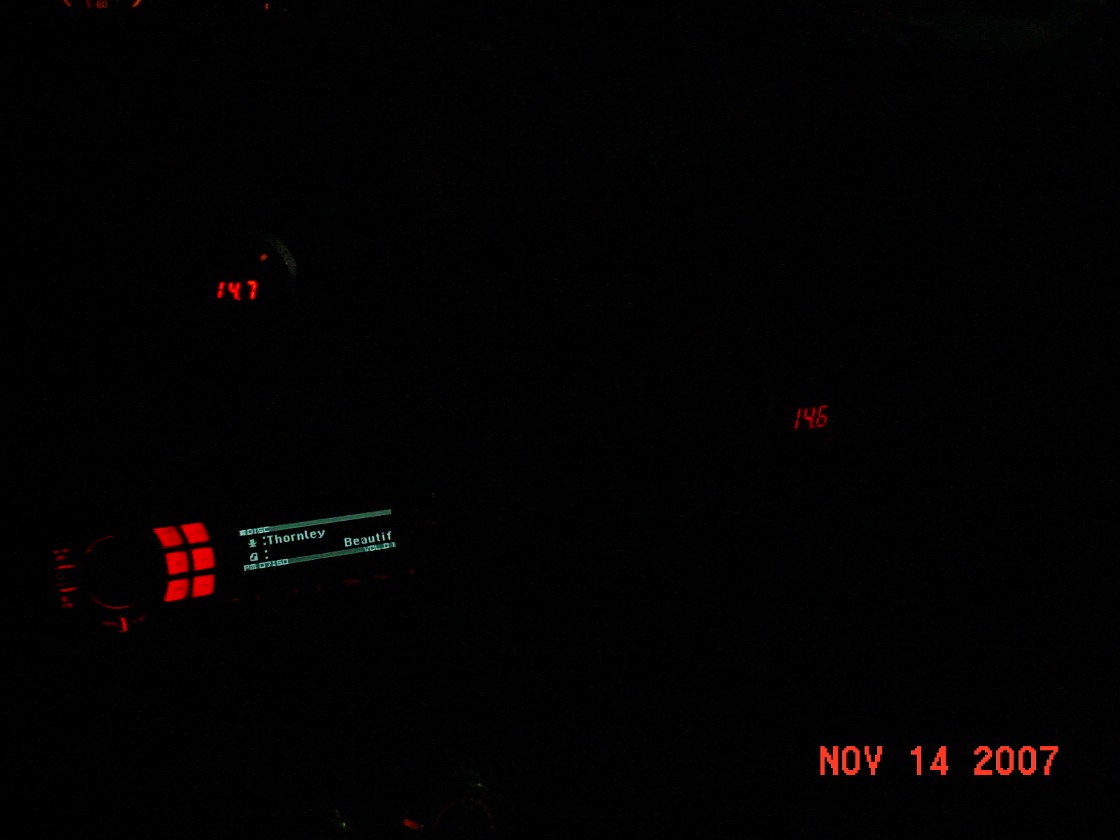

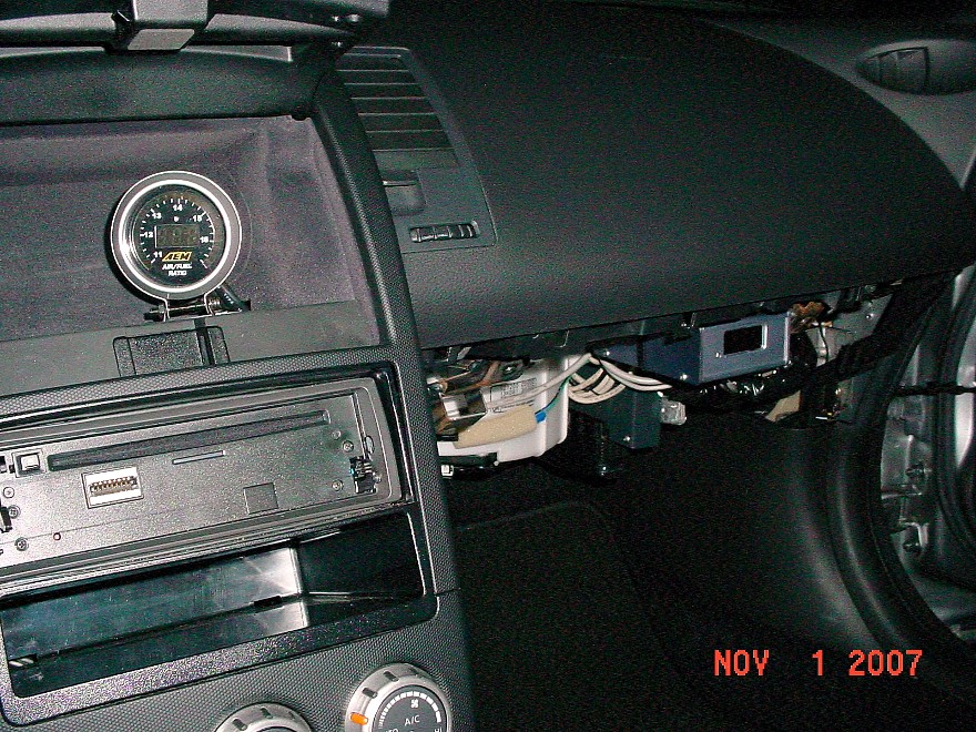

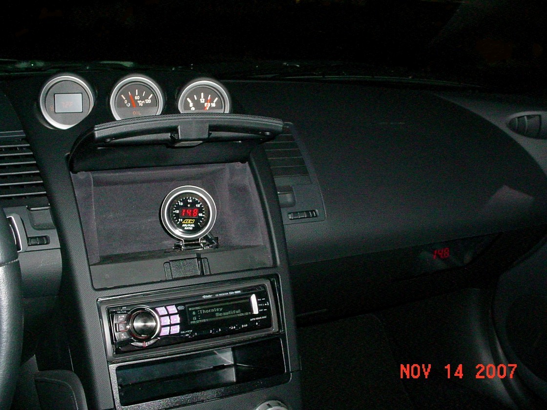

Here's how I mounted my tuner (on passenger side):
https://my350z.com/forum/tuning/315130-txs-tuner-install-so-you-can-see-the-afr-readout.html
