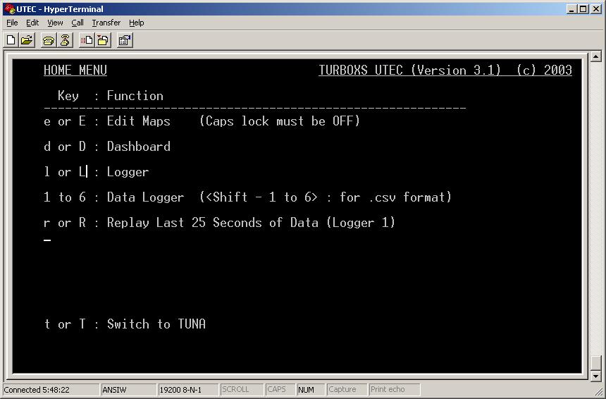

Originally Posted by QuadCam
the utec doesn't have an RJ12 port. the rj12 port is only on the tuner.
Connect the utec and tuner the way I listed a few posts back. Once you are connected, you can toggle between the UTEC and the Tuner within the interface, while connected of course.
Yeah, it'll look like this:
"TUNA" is TXS's slang for Tuner. :-)

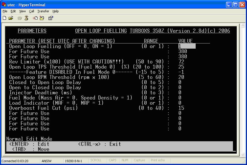

Originally Posted by gothchick
Open/closed loop fueling - Same thing for NA. No different than boosted.
"Closed Loop" simply means the ECU is driving the injectors & timing based off it's own targets.
"Open Loop" means the UTEC is driving the injectors & timing off it's own internal user defined tables.
There is a 'transition' from closed loop to open loop and back again, as the ECU and UTEC trade off control of engine management.
So from what I understand is that, Ecu runs Closed loops from 1 - 1600 rpms and UTEC controls it after. Or so I presume atleast, because you can switch different maps under 1600 RPMs correct?
You can set the open/closed loop threshold to anything you want... Mine is set to 25% TPS and 2000 RPMs.
