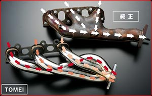

Originally Posted by armt350z
Ditch the TB spacer... That right there on a N/A car is a waste and has been shown To actually make you lose power. you dont have a need for any vacuum lines so why have it? I've never seen the tomei headers in person so i cant speak on those, but its another area that potentially can hurt. plus the fact that aftermarket headers seem to lean out your AFR at certain rpm ranges. But you seriously need to get a reflash or tune on the car, the factory ECU just will not adjust to make the most out of your mods. With UTECS running about $750 theres no reason not to, plus it can easily carry over to FI.
this is Tomei headers:
and i got them along with Tomei test pipes.
http://www.tomei-p.co.jp/_2003web-ca...exmani_en.html
