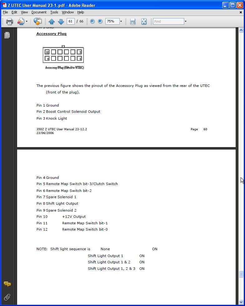

Doesn't the knock light just plug into the UTEC accessory port?
Here:
Attached Thumbnails Has anyone got the utec knock light to work on their z ,if so how?-z-utec-user-manual-23-1.pdf-adobe-reader.jpg

Old Jan 16, 2009 | 07:08 AM
gothchick's Avatar
gothchick
Posts: 3,300
From: ATL
Ah yes, here we go.
Knock light = pin 3 on the accessory port.
Ground = pin 4 on accessory port.
