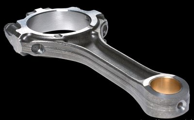

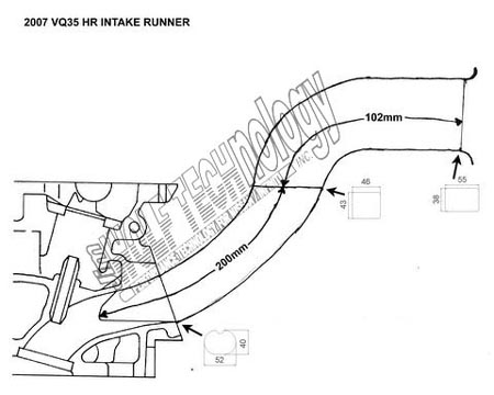

It's surprising to me how many people are surprised at the differences and changes made from the DE to the HR, since they were all documented well before the new engine's release. JWT even did a tear down to inspect the rods and pistons, measured the intake tracts and runner length, and posted it all online. But it seems people missd it. Maybe not a lot of people are on the Fresh Alloy forums or saw the old NissanPerformanceMag sites where this was all posted. Therefore, I think a sticky needs to be made from this for this site. Otherwise, we'll have the same questions posted every week about transplanting parts and what's been changed between the two engines.
I love the new bed plate on the bottom end. This should make fabricating a dry sump system much easier and allow the engine to sit lower. The HR already sits slightly lower than the DE, but I bet there's at least another half an inch it can come down with the lower pan gone.
The larger main and rod journals will be nice too. According to Mike Kojima's inspection on the HR back in September, the rods are forged and much beefier than the DE's stock rods. Can you guys confirm this?

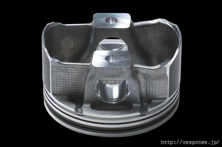

The assymetrical pistons are nice, but the top piston dome is not much different than the DE. However, the pistons come with an anti-friction coating from the factory and the top ring lands are hard anodized. All are good improvements over the DE.

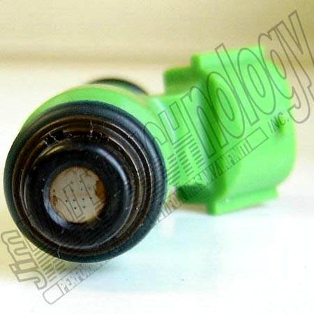

The injectors are supposed to have an iridium center electrode to eliminate fouling on cold-starts and a newer 50 micron droplet pattern. From what I understand, these were developed for the new GT-R and other turbocharged engines by Bosch to help these engines maintain good cold start and clean idle characteristics. Any idea on what they flow and whether they are swappable in the DE?

Pics of the rod (you can see the forge line), piston (you can see the anti-friction side coatings), injector, and intake measures by JWT:
Attached Thumbnails FP Exclusive 1st:  The VQ35HR Dissected-11rod.jpg   FP Exclusive 1st:  The VQ35HR Dissected-12piston.jpg   FP Exclusive 1st:  The VQ35HR Dissected-19injectors.jpg   FP Exclusive 1st:  The VQ35HR Dissected-jwt-vq35hr-spy-pictures-7.jpg

When we get a chance, we will check if the lifters fit the DE. In regards to the rods, the DE rods are also forged, but are just wimpy. As you mentioned, the HR pistons look very simliar in construction to the DE. Looks can be deceiving, and some cast materials can be just as strong is a low end forging. So untilpeople start pushing some boost, through these engines, its too early to tell how it will hold up. No doubt, my gut tells me this is a much stronger engine...but my gut has been wrong before!

I knew the DE rods were forged but wimpy, but there was some rumor that the HR rods, while larger, were cast pieces. The rods look larger, beefier, than the DE rods... but I haven't seen either in person- but I'm sure you'll let us know when you have a chance to pull them out

The injectors, if they flow enough, might be a good deal for the mildly done FI crowd if, in fact, they are designed for better cold starts and cleaner idle with turbocharging in mind. I understand it's one of the components that attribute to the SULEV rating.

On a small side note, does anyone have a direct side by side comparison of the rev-up and non-rev-up rods?
Keep up the good work Sharif, and let us know all the goodies going on in there.
I think they were the same except for the rod bolts, not completely sure though.
That is my understanding as well. According to the Nissan press release on the 300hp rev-up engines, only upgrading the rod bolts for higher rpm use are mentioned, not all new rods.
