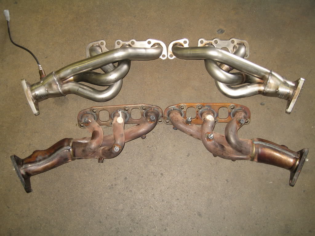

BTW finally got the pics of stillen headers next to OEM manifolds....
Old Aug 23, 2008 | 03:09 PM
  #65
infinite's Avatar
infinite
Joined: Jul 2008
Posts: 658
From: Los Angeles, Ca
the collector is where the difference is

Yea bro I had the same problem. Stillen rushed the headers and didn't test fit it on the car so the first set of headers they sold had the header hit the bottom of the stering column. Here is a thread I posted. https://my350z.com/forum/vq35hr/3794...er-defect.html It has a picture of the problem. As you turn left that bolt on the bottom hits the header making it hard to turn right and a hard left. They redesigned it so just call them up tell them about this, act pissed but polite and they will send out a new header and if your very lucky like me they will also pay for the install of the new header as they totally fcuked you and it not your fault. Just don't take their bs and make sure to talk to Kyle Millen. He's the only one that can get anything done. Hope this helps and you resolve your issue.
-Arsh
