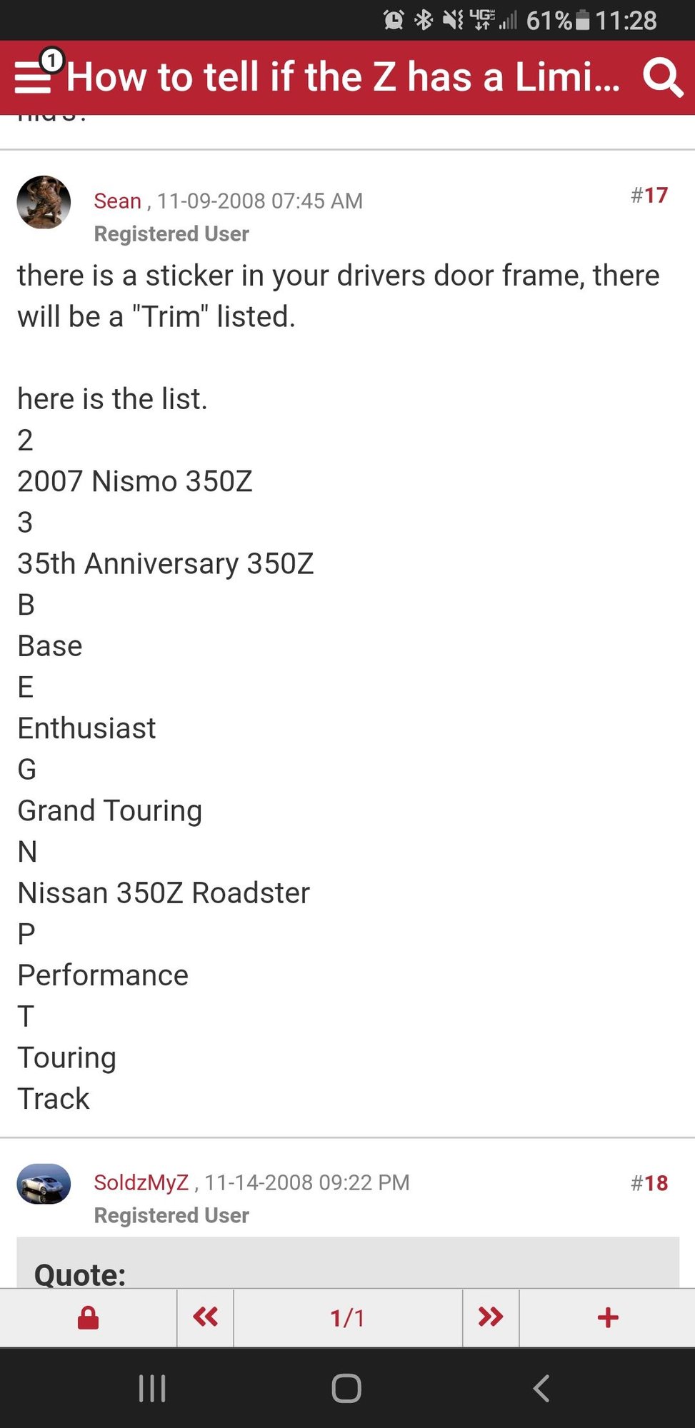

I went reading through the forums on here and he said the trims say b for base e for enthusiast g for grand touring and not sure what else he labeled the rest but the post is on here. I also have the aluminum/chrome kick plate and pedals. Thanks for reply

Never seen a post listing models by such a coding scheme. Do you have a link?

Yes it took me a minute but I found a link you scroll down to a comment by a guy named sean like 6 comments down. I did find out on reddit the code G stands for carbon interior color. I got it from a side dealer who got it from a auction it was repossessed from previous owner and good thing because he beat the hell out of it. I found a million hidden problems that I'm now stuck fixing. About 7 to 8k in stuff to fix.
https://my350z.com/forum/buying-leas...ferential.html

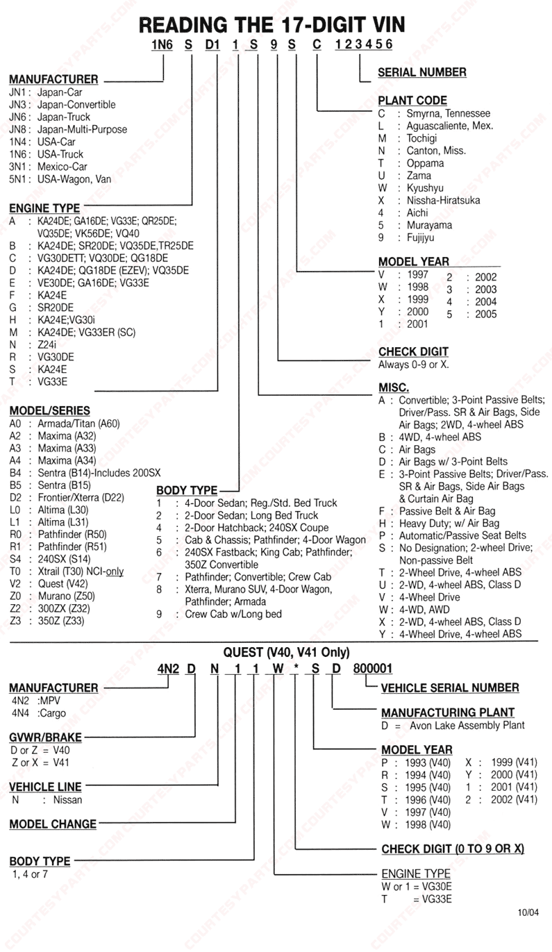

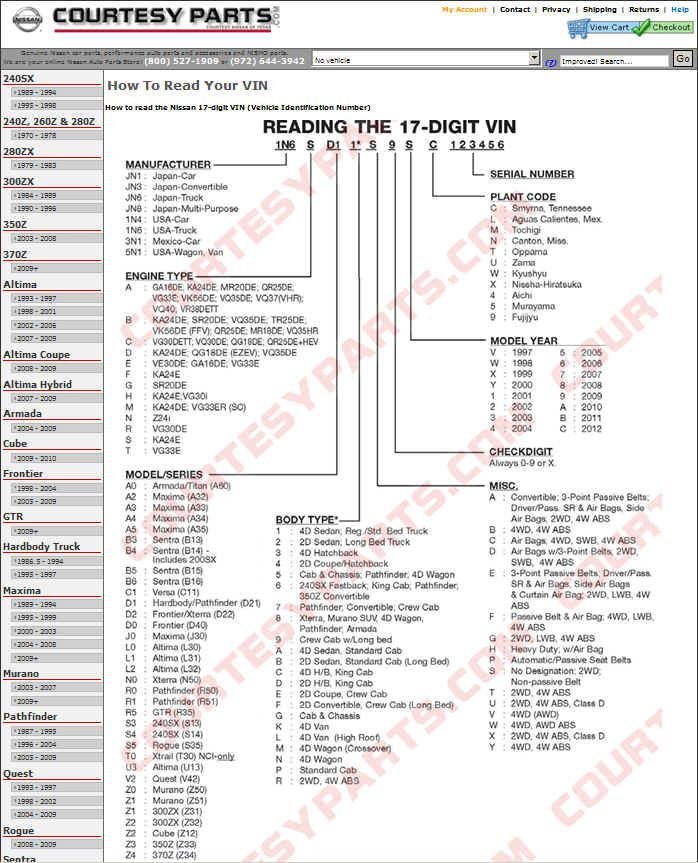

Vehicle trim level/accessories ARE NOT spec'd in the VIN. (Someone above had an overactive imagination and is passing along erroneous BS as "information".) Many "accessories" are DEALER INSTALLED on existing cars which are assigned VIN (and tags) BEFORE leaving the factory.
Use the VIN Decoder: https://my350z.com/forum/vindecoder.php
Or look at this OFFICIAL NISSAN VIN breakdown:

Thank you and I ended up figuring out on reddit the trim code is for the interior color and code G stands for carbon interior/color. I also don't think that vin breakdown would work for me since it's HR and they aren't even included on your list. It ends at 2005 and vq35de no 08 or VQ35HR. Im not sure if it still applies. Thanks

Yes, there is an identification plate that denotes the body and interior colors. But that's it. Indicates nothing about the trim level, e.g., Base, Enthusiast, etc. (whose names indicate how the car is equipped). Again, this is not reflected anywhere in the VIN other than a given VIN is cross referenced to the trim level BY THE MFGR but is not encoded in the number itself.
As far as whether it applies to the ever special "HR" (of which 350Zs are only designated as such by people wanting to feel superior), Nissan VINs (as are every other mfgr) subject to the same VIN encoding throughout their respective lines and do NOT change year over year. They are INDUSTRY STANDARDIZED BY MFGR. The VIN is pertinent to the entire car package including body, chassis, engine and other serialized components like the transmission, differential.
There is NOTHING special about whether it is a DE or an HR or a VHR, a VIN is a VIN and is definitive and the encoding does not change. Period.
Here's an updated VIN chart up through 2012 MY Z34 if this will finally get the point across.
