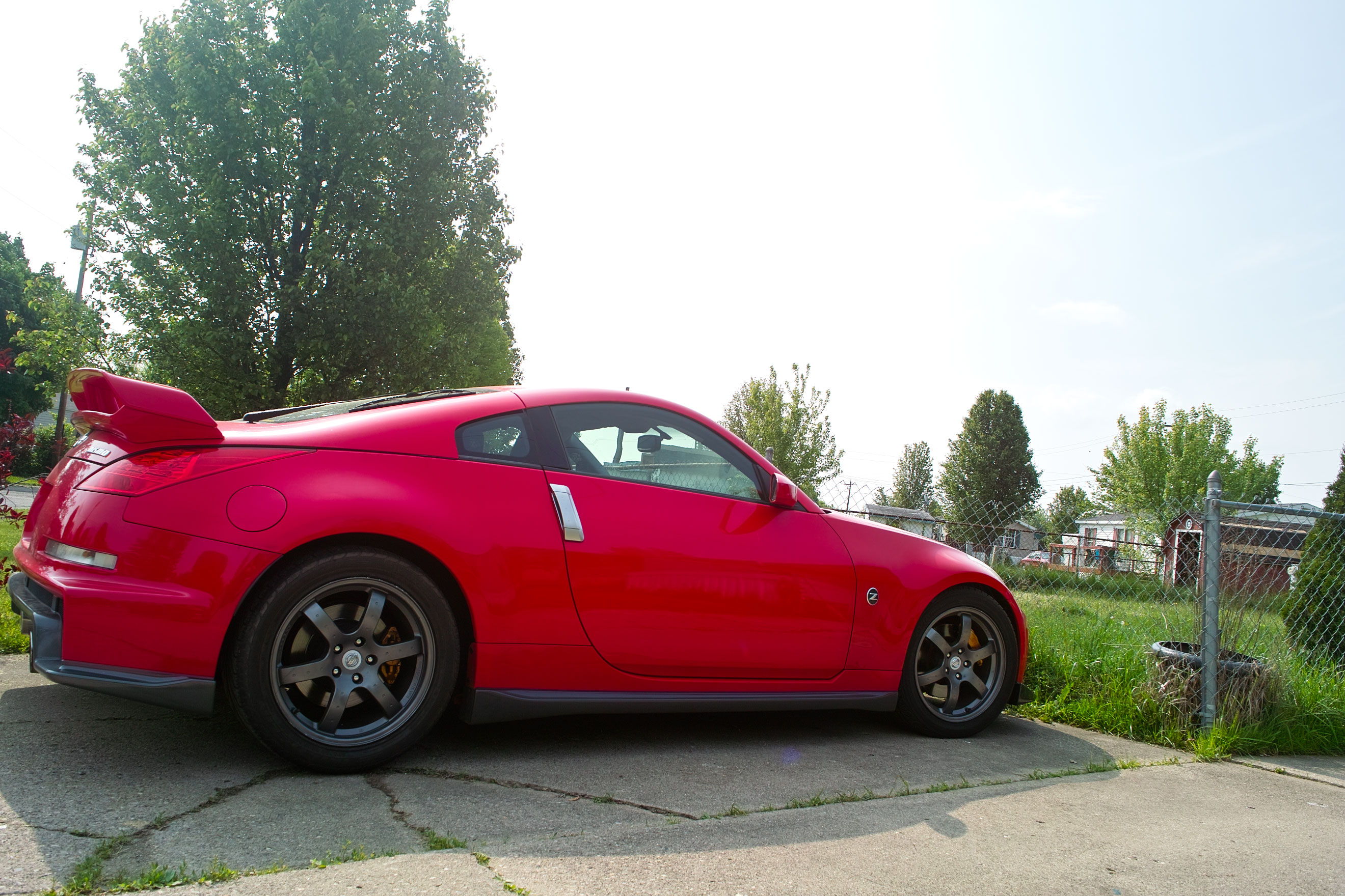

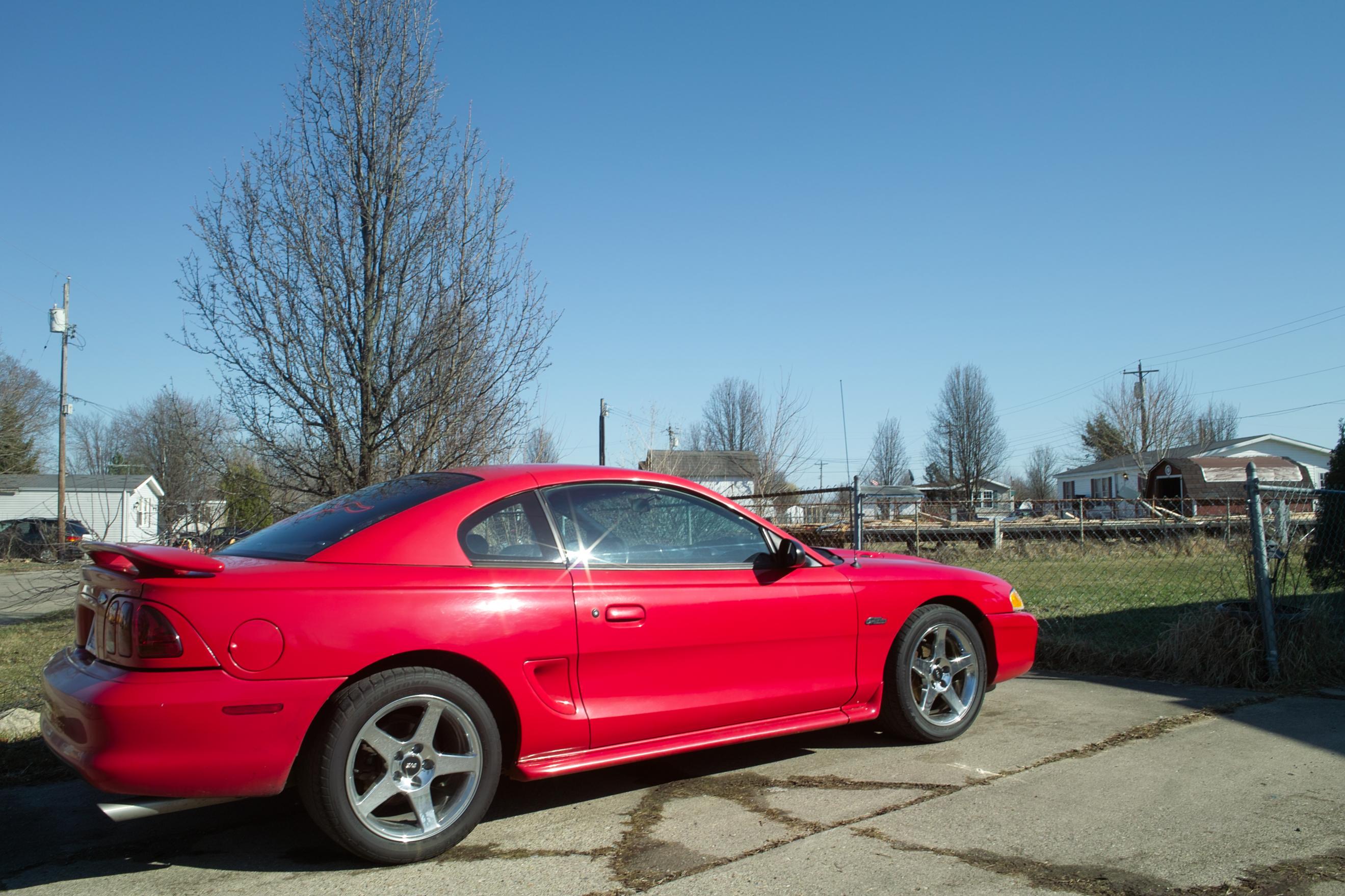

From: Oxford, Ohio
275/40/18 on the rear. 245/45/18 on the front. Yeah I know the fronts are taller than the rear. But short on money at the moment. They are on the V1 Track rims. 8' fronts, 8 1/2 rears. The 275's seem to fit pretty well on them.
Picture of my Mustang also. Has 305's on the rear. I know I sort of like Red cars lol.
Attached Thumbnails 18" Wheel & Tire Discussion Thread-sdim0305.jpg   18" Wheel & Tire Discussion Thread-new-tires.jpg
