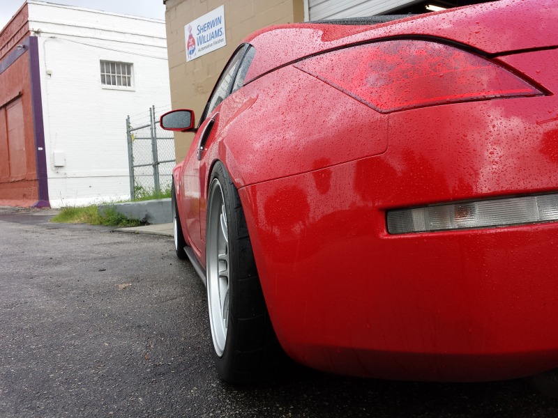

18x10.5 zero offset thanks to a 15mm spacer, tire is 285/35/18 Nitto 555R Drag radial
