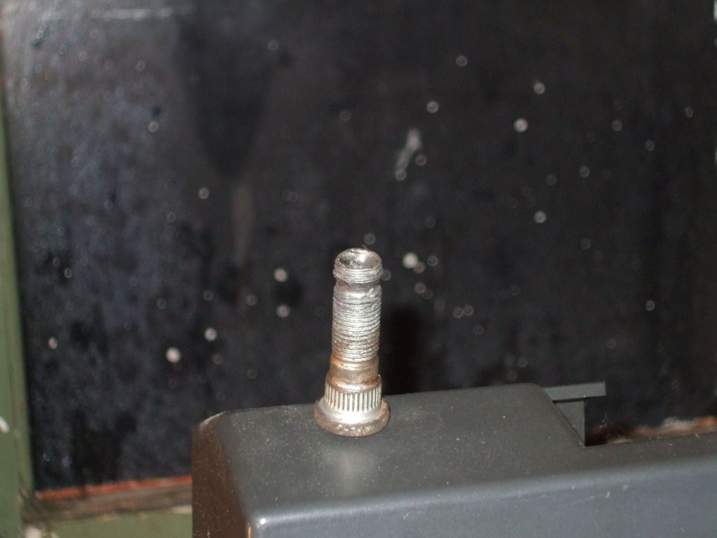

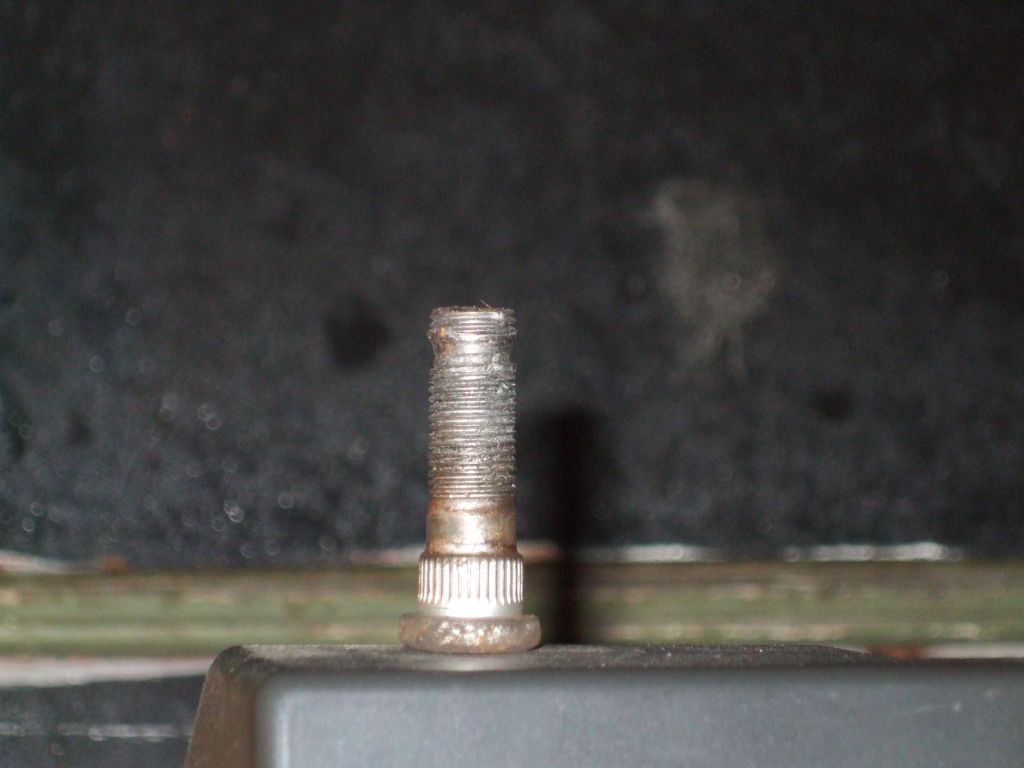

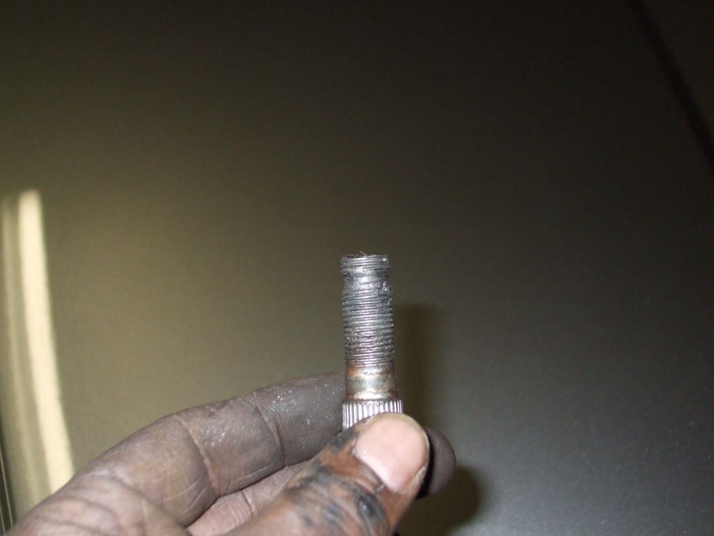

Well finally got 'er off today. I ended up drilling the lug nut & could see through the opening that the lug was spinning but the stud was still. Opened it enough to stick an extension in it & tapped the stud out some & the lug came off. When I had the loose lug nut it caused an indentation around the surface of the stud. So there were threads on both sides of this indentation & the lug would not thread to either side. Pics will clear this up. Anyway, its off & the stud has been replaced. Now I can mount my last wheel tomorrow.

Here's the stripped stud. After getting it out I know this could have only happened when I had the loose lug nut. Glad I found it this way & not when I was on the side of the road.
