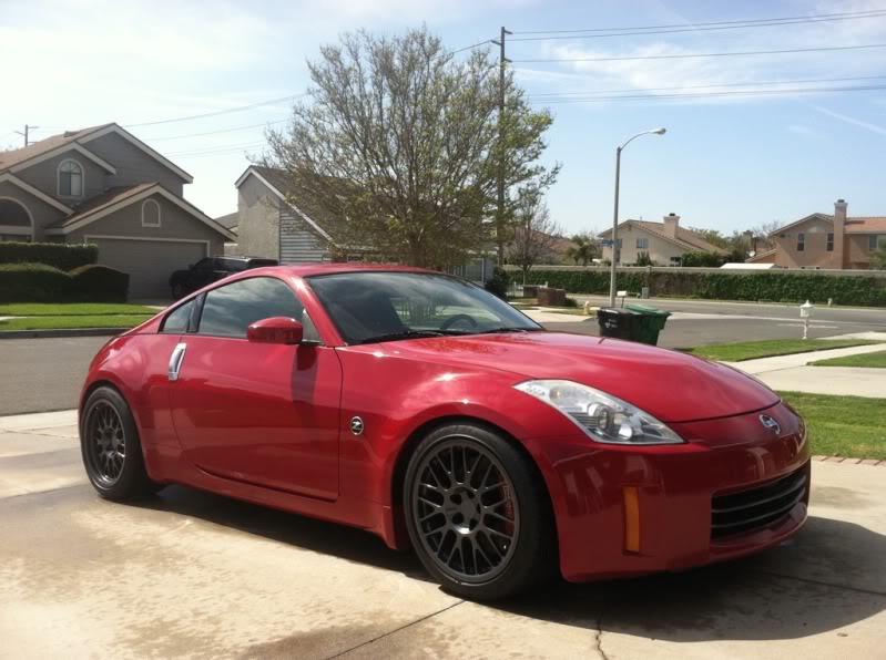

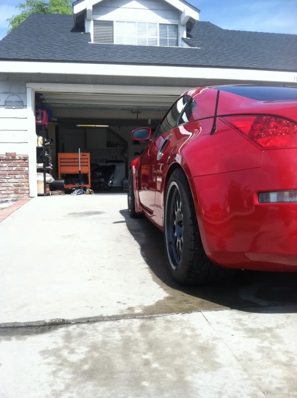

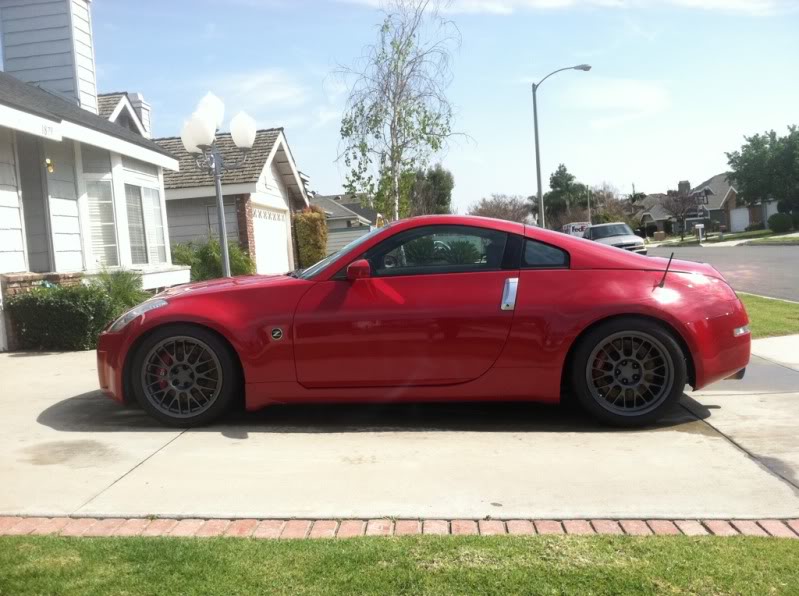

Its done!
Front: 275/35-18 on 18x10 +25, -2 degrees camber, zero toe.
Rear: 295/35-18 on 18x11 +30, -1 degree camber, 1/16 total toe in.

Old Mar 12, 2012 | 01:33 PM
  #3253
SoCal07HR's Avatar
SoCal07HR
Joined: Apr 2011
Posts: 824
From: Socal
Originally Posted by Total D
I'm going to keep the stock body for right now. When the time comes for me to do widebody, I'll adjust fire then. For no,w I just want to fit the widest tire/rim I can with the body the way it is. If its 315 on a 11 that works too.
If that's the case i'd go with 11 inch wide +30 with a 315 and set camber to around -1.

Originally Posted by SoCal07HR
Its done!
Yowzers. . . looks awesome

I think 12" rears are doable at about +30 to +33 offset. Assuming they clear the suspension inside, and I think they will based on SoCalHR07's measurement pics, they will only stick out 1-4mm farther than the popular 10.5 +15 setup. 345 would be pushing it, but 335 would probably work. I'll have a real answer for you in a few weeks once I get my new wheels in.
I would not go any closer the the damper in the rear than mine are! My wheel contacted my damper at around -2.2 camber going through dips. My pictures are with no weight on the suspension and the wheel gets MUCH closer to the damper when compressed. I have about 10mm clearance at my ride height and I'm sure it comes very close as it compresses. Get spacers and pull the crap out of your fenders.
