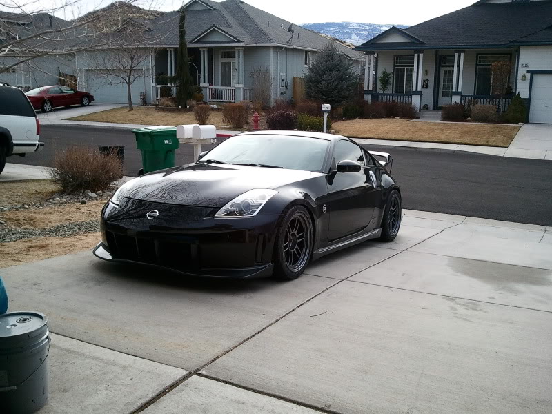

I've been waiting a while to post in here, but I think I qualify.
18x9.5 et+15 275/35 tires up front
18x10.5 et+15 295/35 tires out back
Horrible picture, but it's filthy.

^ More pics, im intrigued

fhumphrey04 - Are your wheels the SBC finish or gunmetal?

Thanks guys, they are the gunmetal finish. Next week I'll have better pictures.

Looks hella good!!!! How much camber you running and are you true or OEM setup on the rear?

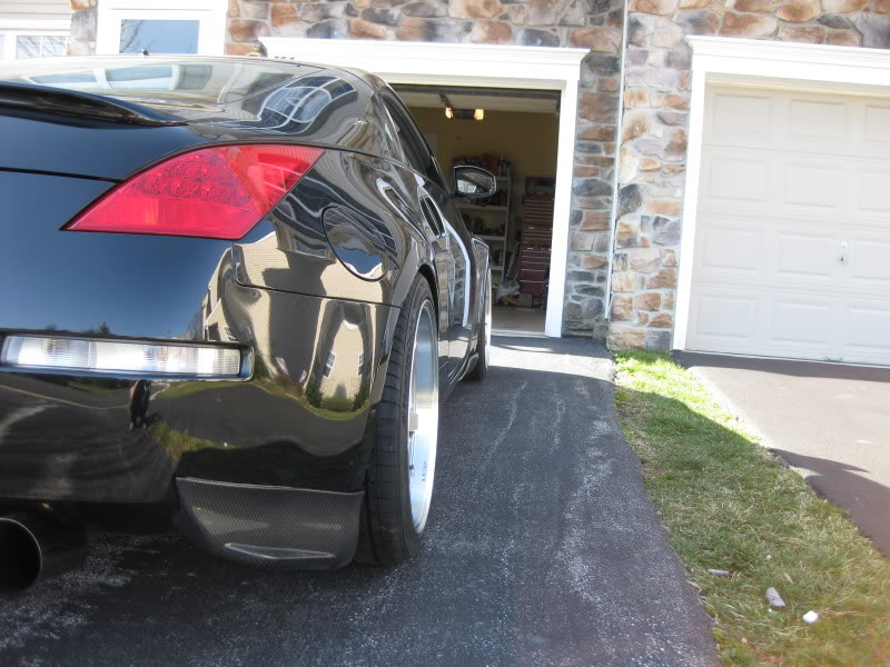

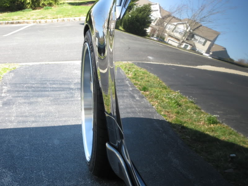

I'm posting here because I think my rear tire setup is closer to "fat" than it is "stretched". Currently running 275/35 hankook v12 on 10.5" wide rears, +12 net offset (+22 wheels and 10mm spacer). Lowered to about 1/2" gap from top of tire to bottom to top of wheel arch. I would like to be at +7 net offset (i.e. 15mm spacer) but I'm pretty sure I'll rub at my ride height.
Anyone running that particular setup, and if so what kind of camber angle did you need to have? Trying to decide whether the improved aesthetic is worth the increased tire wear.
Here is a pic for reference:

Im running the exact same set up, on same set of rims. I had to slightly roll my fender lip it rubbed bad on hard bumps and dips. I have not yet got it aligned. I run gf210 springs. Once i rolled my fender it eliminated the rubbing to a minimum.

Fenders are already rolled so I currently have no rubbing at +12 offset, but I'm trying to figure out if +7 offset will cause problems.
I have a set of 15mm spacers, so one way to test it is obviously to put them on and go for a drive. But that's a potentially destructive test if the tire rubs and I'd like to avoid it. Is there a way to compress the rear suspension to check for tire/fender interference using a jack or some such thing? Seems like I would have to remove the spring to do that without lifting the entire car even more.
