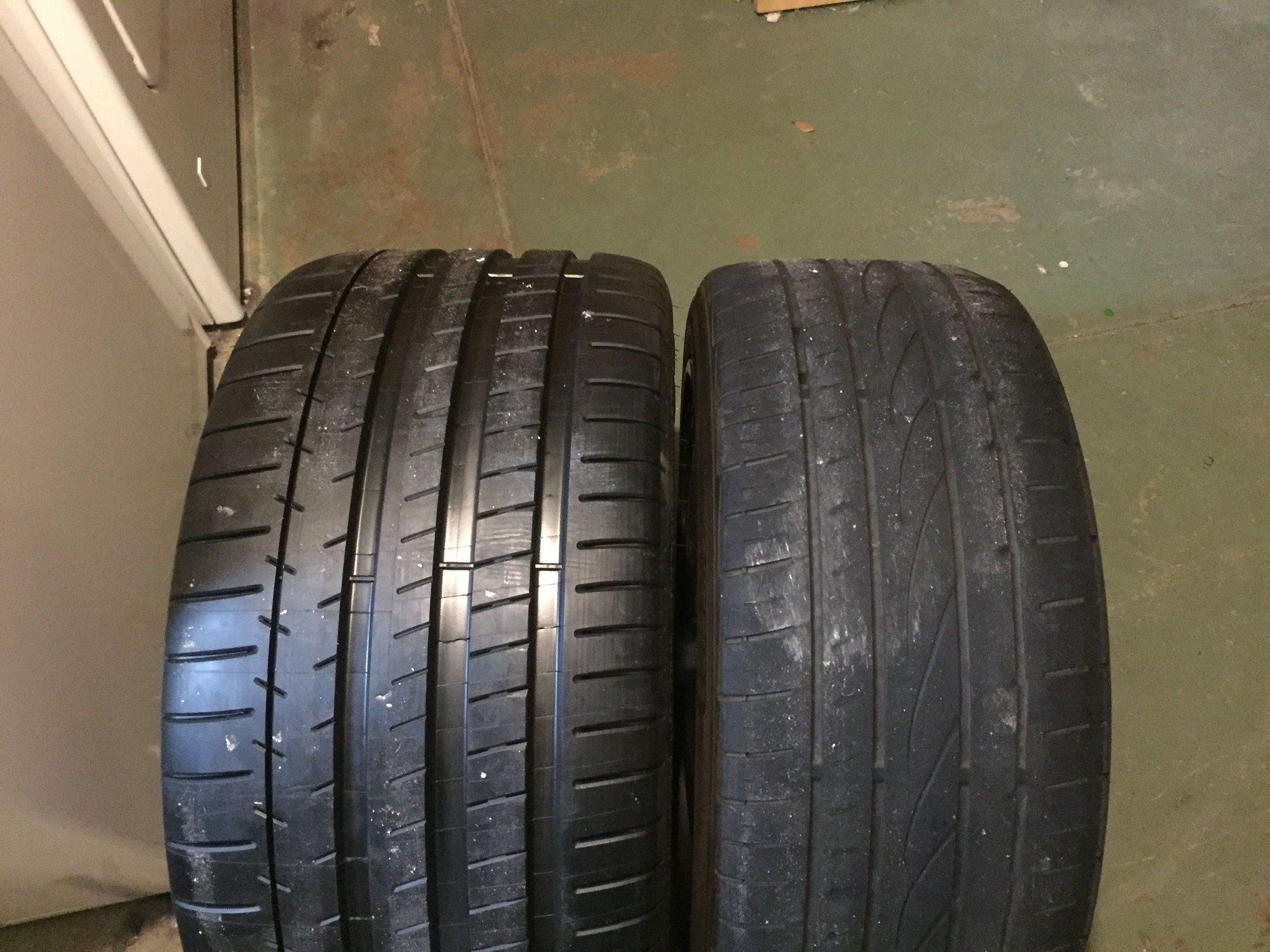

This thread was a huge help in finding the right wheel and tire combo. And I do have to roll my rear fenders. I'll be doing that very soon.
Enkei GCT01RR
Front 18x9.5 +22
Rear 18x10 +22
Michelin Pilot Super Sport
Front 275/35
Rear 295/35
245/45 VS 295/35

Those are stretched though... no stretch on a 9.5 is a 265. Most of us on 9.5 run 275 or bigger.. 19x11 should be a 295 - 315 as well. Just a heads up

295's on a 10" wheel gives some considerable overhang. Kind of a nice thing since parallel parking is a must here in SF.

I'm running Michelin Pilot Super Sports. 295/35.
