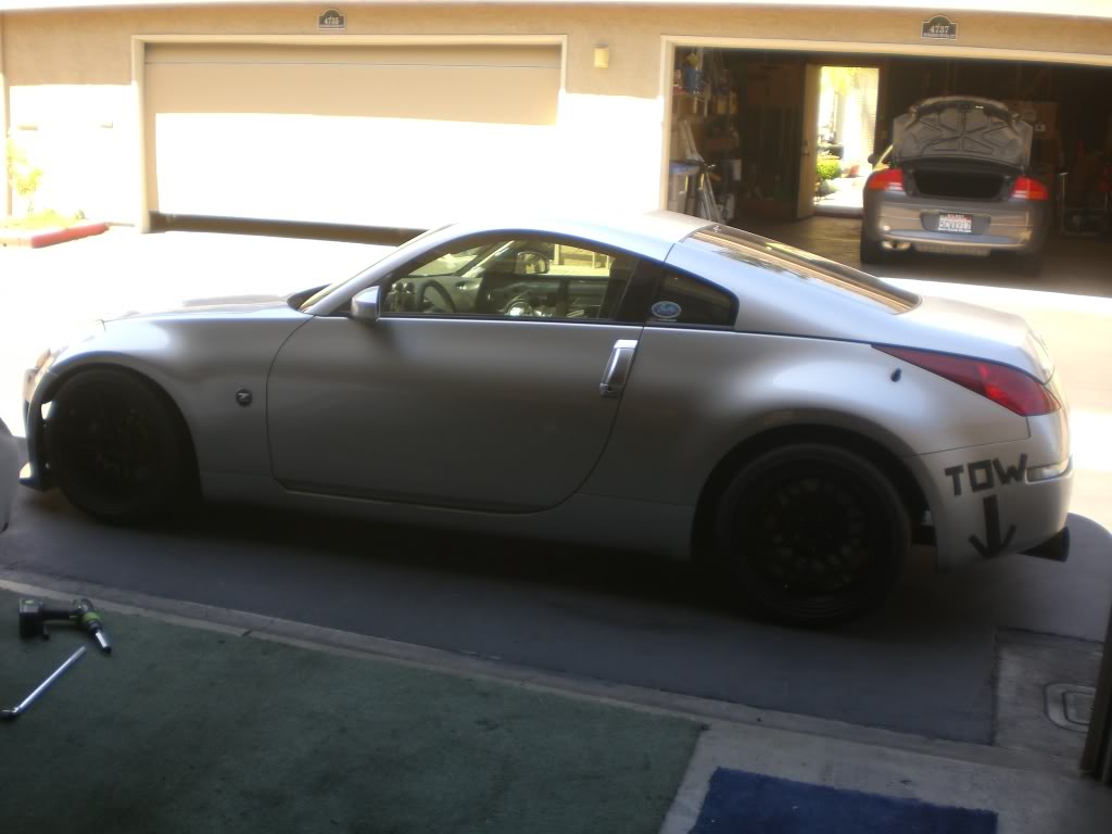

These are 18x10.5+15 but you get an idea of how much the fronts will stick out:

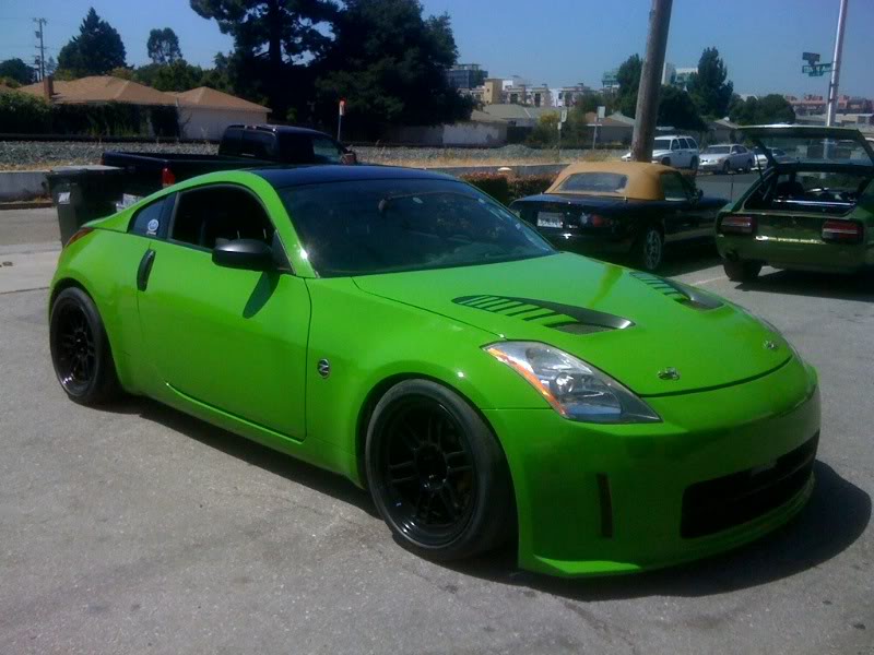

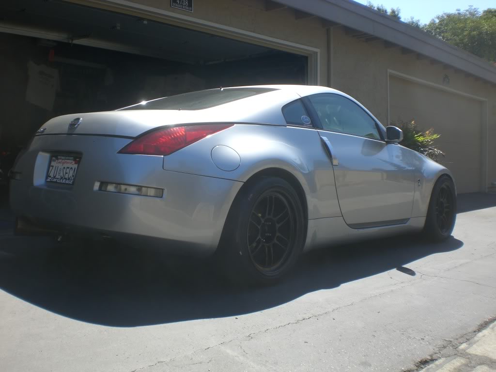

10.5 +15 fronts are biggins, but they certainly can fit with the right tire and suspension geometry. Are they a 265/30/19? A 265/35/19 is a pretty tall tire for the front (with a 10.5 +15 wheel that is). Shown below are 285/30/18 tires (all around), which are 1.6" shorter than your 265/35/19.

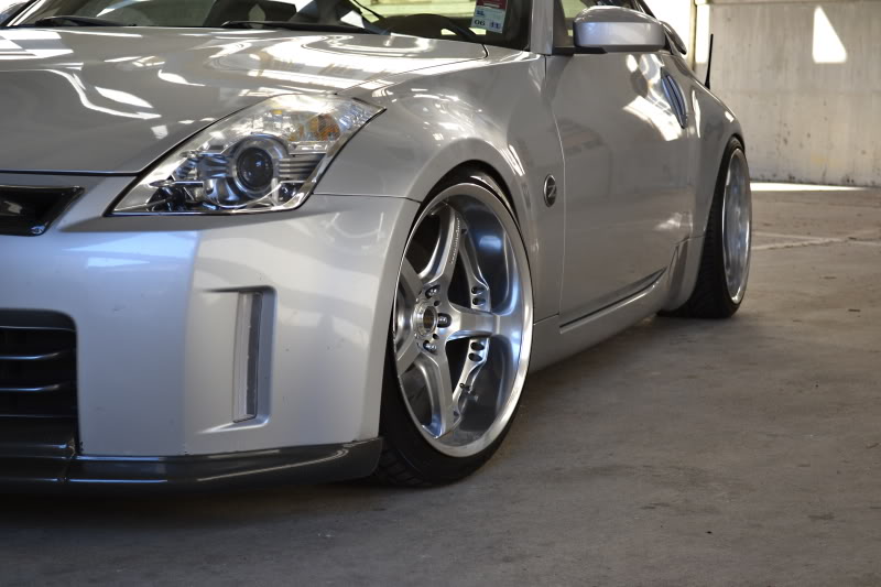

My set-up is 19x10.5" +18 up front and -2 rear. Tires are 255/35 and 265/30
