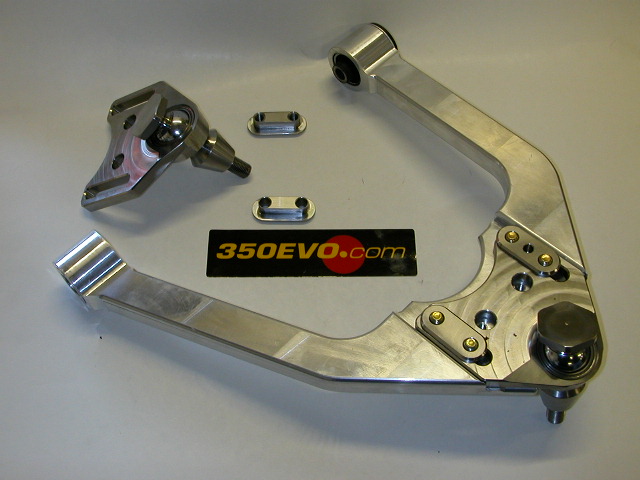

For lowering you will need some of these....

and those are? :-)

The new 350EVO front adjustable control arms. If you lower your car you will not be able to get you front end back to alignment specs as there is no camber adjustment on the front of the 350Z. These allow for easy camber adjustment for the front suspension and were developed and proven on our 350Z we race in the Grand Am Cup series.

Hmm.. . . something I may consider :-)
I haven't heard anyone using these with the setup i'm looking for. Looks like I have another item to add to my list of research, lol

How much are those? LSDunique have them on the making too right?

No I believe that he is making rear lower arms.....these are front upper control arms.
