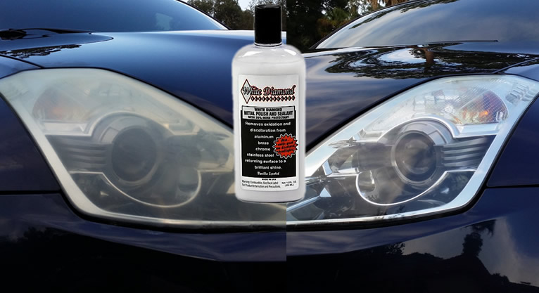

Also restored my headlights last night. They were long overdue. I usually use the 3M kit to wetsand and polish, but I decided they weren't that far gone to justify all of that.
I used some White Diamond Metal Polish & Sealant to remove the oxidization on the lamps and finished up with some Zymol wax to serve as a temporary protectant.
They came out nice for very little effort. Much better than Plast-X could ever do.

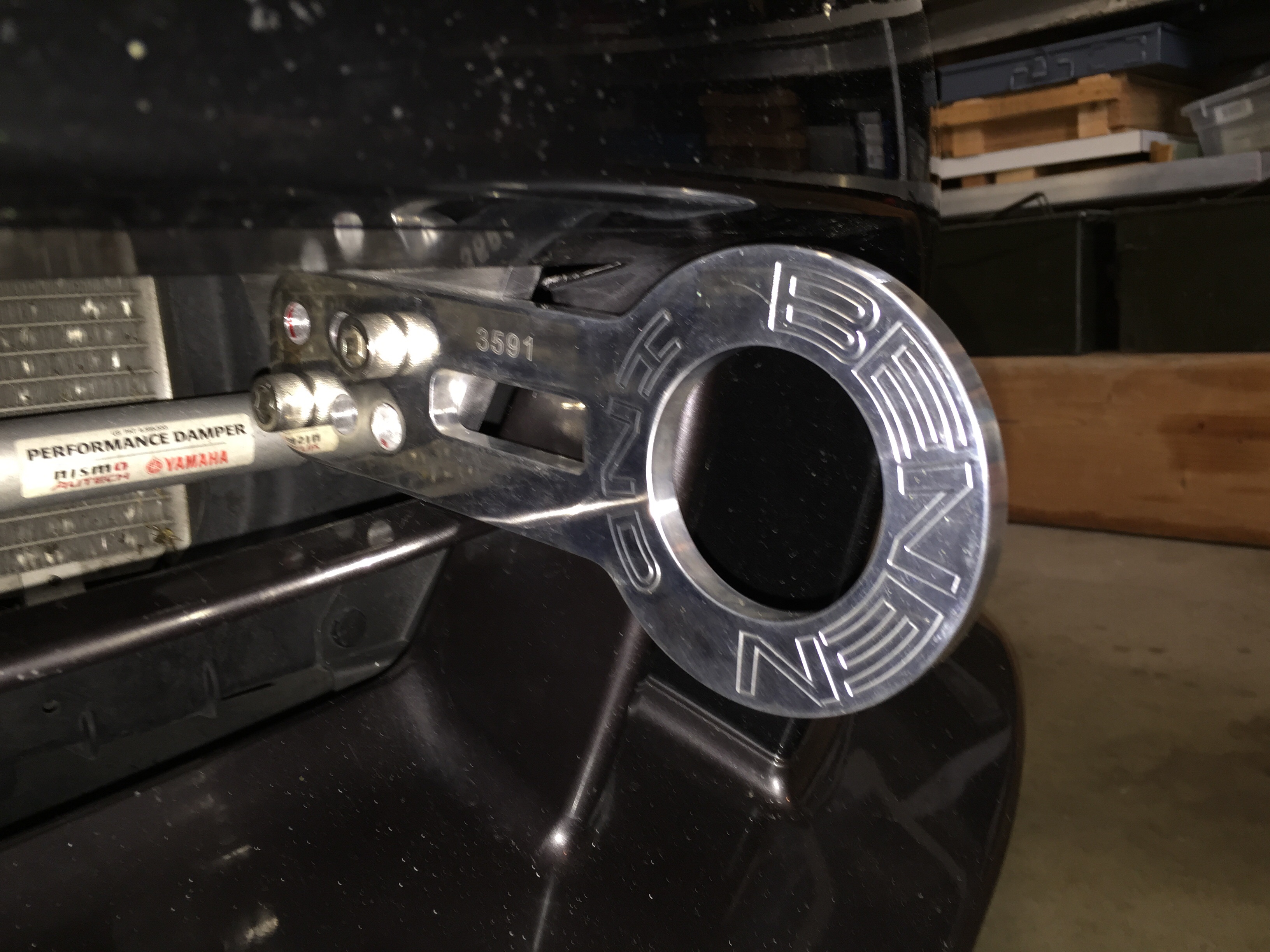

fabricated a front tow hook bracket
https://my350z.com/forum/exterior-an...ment-help.html

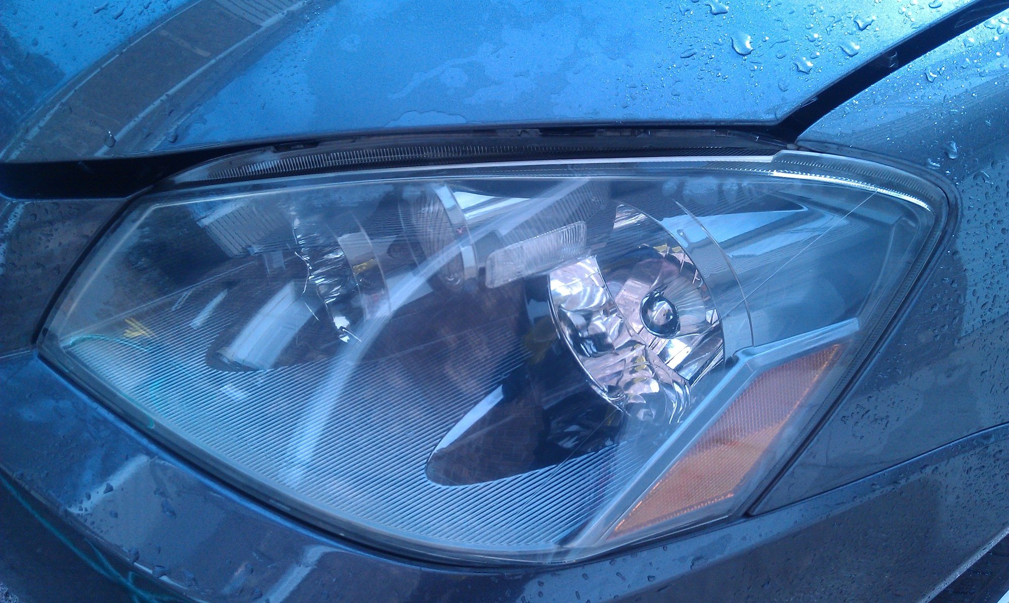

This doesn't even qualify. But pic of amber led's blinking. Glam shots ltr. DRL is visible, but off.
Actually, if I had it to do over, Diode Dynamics has 6" led strip that is DRL (white) until you put on blinker. Then it blinks amber.

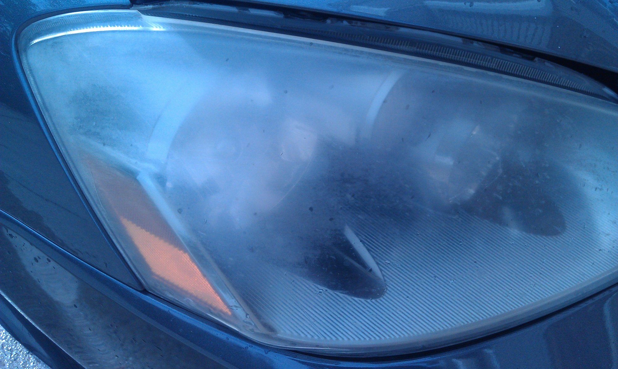

My goodness I need something like this. I have the right light fogging up more and kind of yellowish than the left light. It looks like she has an eye booger or something lol.
Go into your bathroom, take out your toothpaste, wet a rag and put the toothpaste on the rag, go to your car, rub the living daylights out of your light, reapply a few times, then top coat it with something. Done!
There are lots of remedies for hazing lights!
