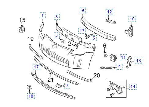

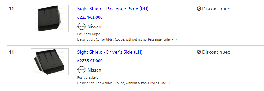

I completed an Oil & Filter change last night (176k miles on the original engine, now). I also had to reattach the "sight shields" that are behind the grille opening of the front bumper. I would call them air dams, to direct air to the PS cooler and radiator. The original trim clips had aged and broken loose, but luckily the shields were still wedged in place. I re-attached them with new trim clips.
And the last thing I did was check/adjust the tension on the accessory drive belts.

He Khnitz,
I had to do the same for my air dams as well. The plastic popper clips in that location seem to suffer from heat soak or maybe vibration, either way, they don't hold up in the long run.

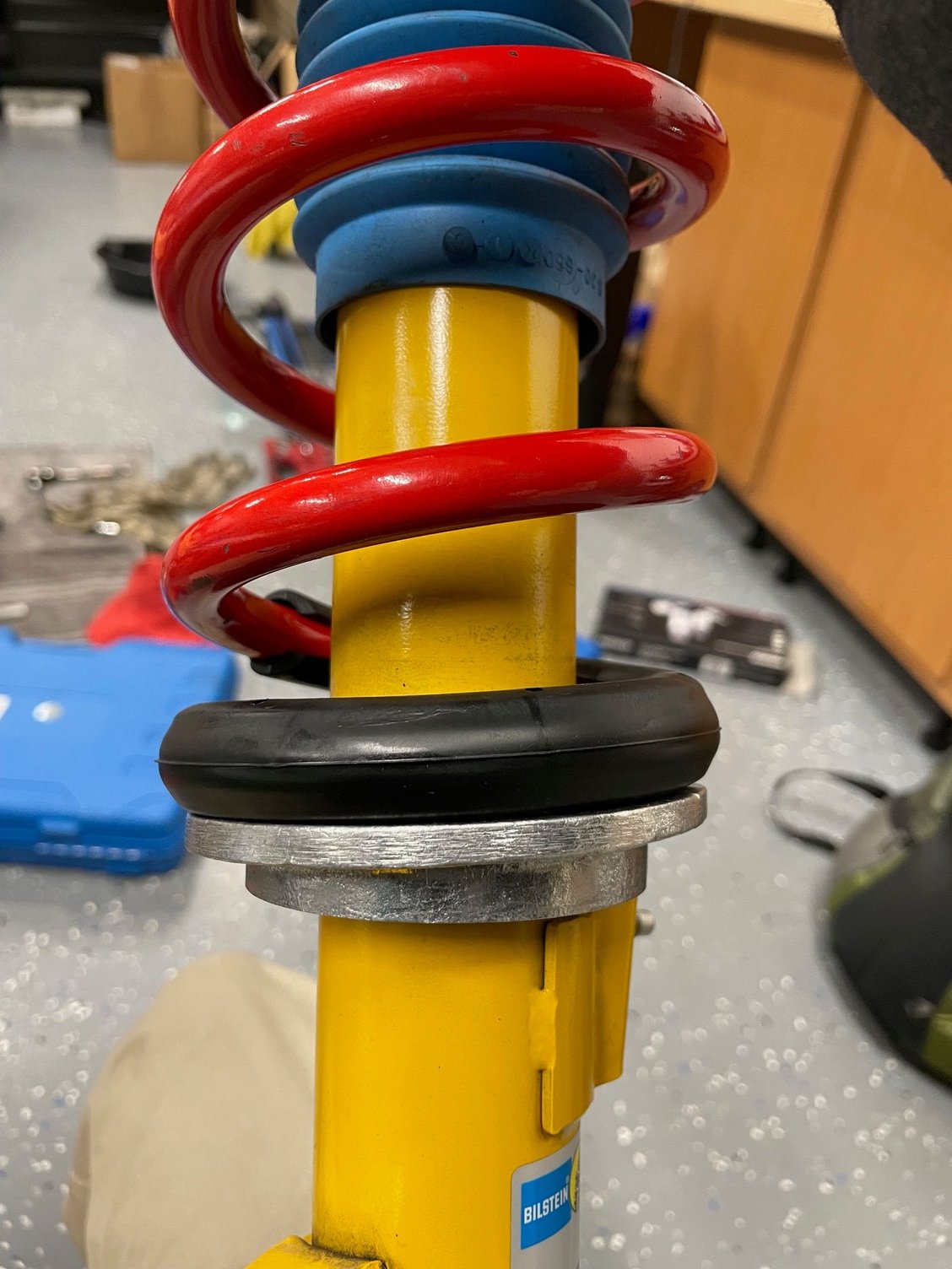

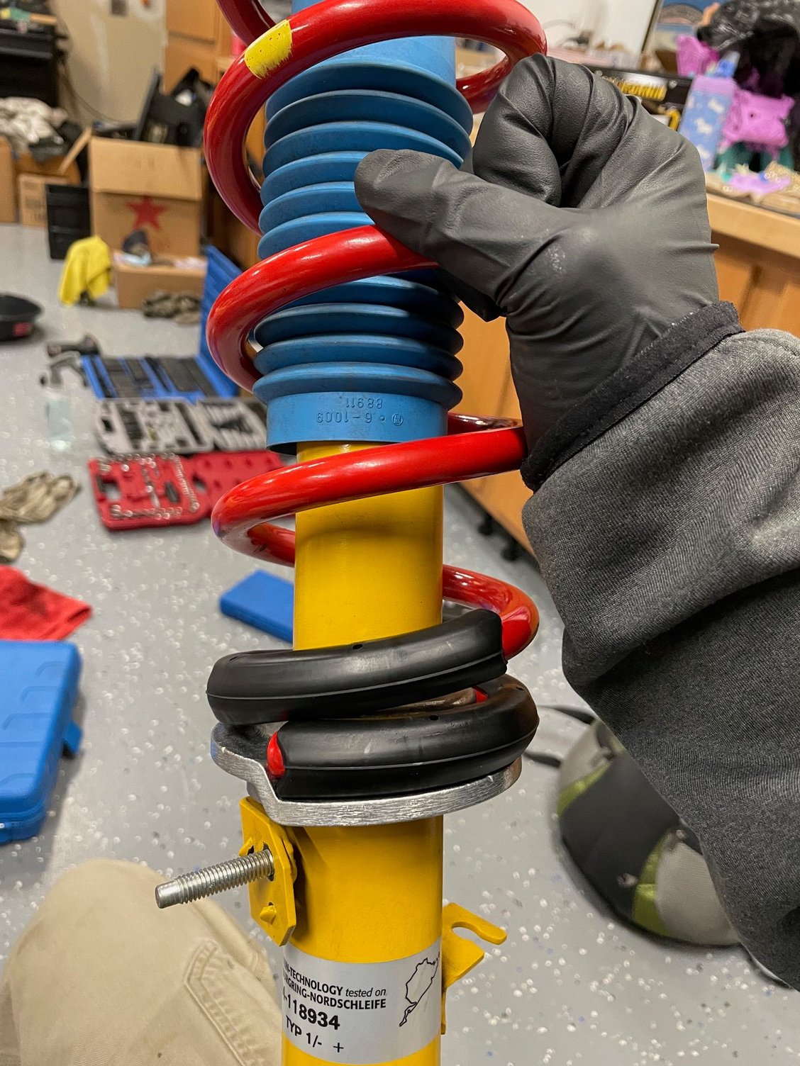

Last weekend, I installed the Z1 Baffled Oil Pan on my Z (wrote a review post in the Engine Tech Section). While waiting for the RTV to cure for 24hrs, I decided I would also tackle the front Coil Spring Sleeves. The originals were disintegrating just like the rears. I also got to try out a "new to me" coil spring compressor kit that my neighbor gave me. Never heard of the brand before, but it's well constructed. Hands down, the best spring compressor kit I've ever used. Short of having a professional shop grade unit (not practical for a home DIY-er), this is probably as good as it gets.
Enjoy the pics.
Cheers!
-Icer
Z1 Large Capacity Baffled Pan.
Coil removed with awesome compressor.
Coil sleeve just started falling apart as soon as I touched it.
New Sleeve installed.
Already looking so much better!
