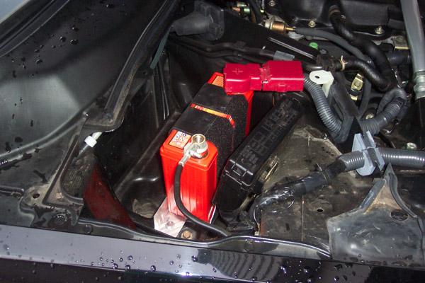

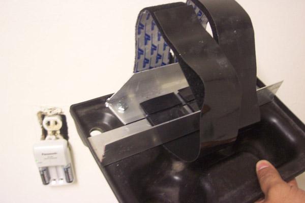

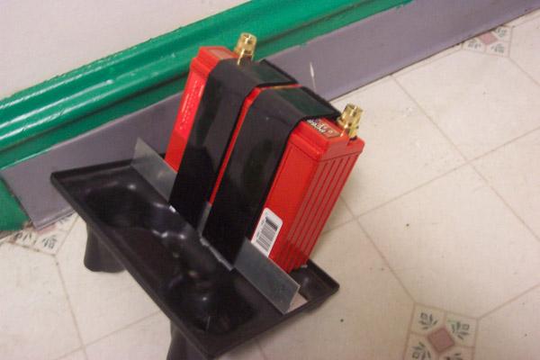

lightest one i've seen:
Attached Thumbnails Aftermarket battery...-275874333undptv_ph.jpg   Aftermarket battery...-275874304fgbuvo_ph.jpg   Aftermarket battery...-275874468vzvopa_ph.jpg
