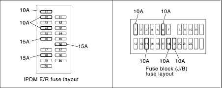

Originally Posted by Santacruzslick
Bump, does anyone know which fuse it would be that could cause this?
There are a bunch of fuses and fusible links related to the lighting in the Z.
Attached Thumbnails Installed stereo...lights don't work now?-snap.jpg   Installed stereo...lights don't work now?-snap1.jpg
