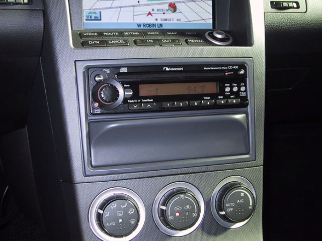

I just screwed the new HU into the metal side pieces that the stock HU was attached to, but I used the Double DIN piece from the Metra kit, so it might be different if you are using the other part. I did have to elongate the holes on the metal pieces when I mounted the pocket from the Maxima in the lower slot.

CAN SOMEONE PLEASE POST PICS OF SINGLE DIN, I mean are there still two slots or what, I'm confused

Yes, there will still be two slots. One for the "single DIN" headunit, and the other will be a pocket.
