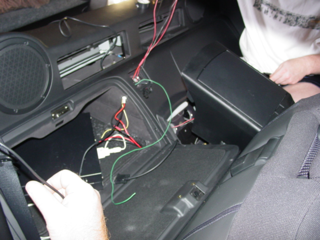

If I am understanding you correctly, all you want to do is to tap into the power at the cig. lighter for your PC?
I used the cig. lighter for power for several things and I didn't remove any panels at all. I just popped out the lighter and exposed the wires behind it, tapped in and tucked the wires back behind the lighter and then popped it back in. The bulk of the wires are in the glovebox.

Whoa, check it out, Dr Bonz is actually Mr. Fantastic of the Fantastic Four. Check out his right hand on the bottom of the picture. Boy can he stretch. LOL.
Well, theres another route to the cig lighter as shown by Dr Bonz.
Charter Member #19
Actually neither of those guys are me. They were a couple of my friends that helped me with the install.
