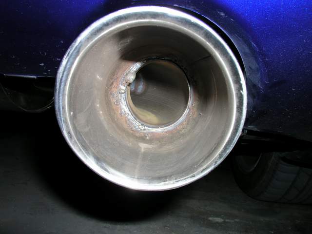

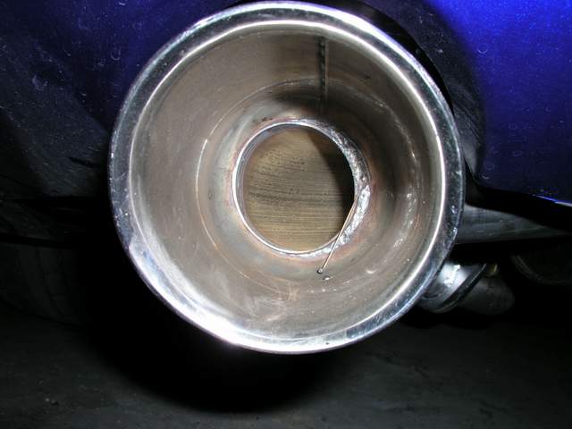

Just discovered again. The welded part inside the the tip of the Exhaust is completely bad quality welding. I'll send you guys a pic later.

Also notice the welding parts inside the tips and other parts as well, the qualities aren't good at all.... I cannot say more about it!

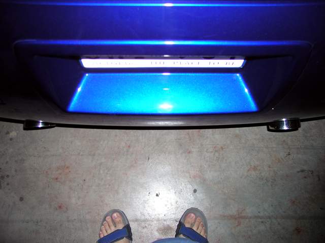

Default The problem Picture
Not allign

inside the welding (left)
Attached Thumbnails Another 2 Hi-Tech in Melbourne-left-hi-tech-weld-pipe.jpg

Inside the welding (right)
Attached Thumbnails Another 2 Hi-Tech in Melbourne-right-hi-tech-weld-pipe.jpg

Nice pair of thongs - did you notice one toenail is cut diff to the other?
HIM
Old Nov 14, 2003 | 12:01 AM
ypwpat's Avatar
ypwpat
Posts: 1,080
From: Melbourne, Australia
very nice observation Frosty yes indeed one of my toe nail is different length but it's off topic
