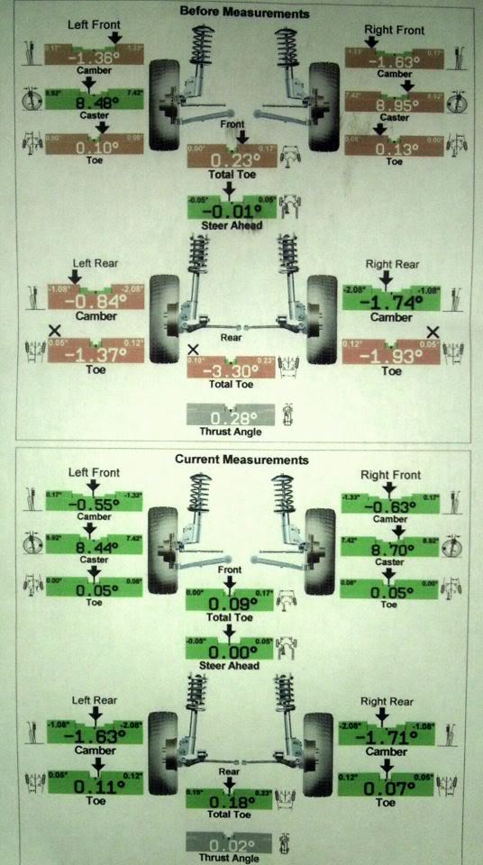

From: North Carolina
OK, Rear Camber arms Rear Toe arms and Front UCA Installed. Heres the alignment sheet....LMK what you think I have 18 inch Factory wheels Rear Eibach camber Arms, Custom Toe Arms and Front kinetix Upper Camber Arms and Hotchkis Sway bars front and rear. BC Racing TRUE coilovers. Converted from OEM style. Will post pictures later but heres my alignment sheet finally....
Some are off what or how does it look, anything I should fix or work on?
New one looks good, wouldn't worry about anything on that after/correction sheet.
What about the rear toe and the rear Camber since I have toe & Camber adjustment shouldn't I be closer? The tail end is kicking out too easy.....that's why I'm concerned....

I do see where that rear end would be a little free, slight toe in and slight toe out on the other side. If you feel its not comfortable make sure they get the right rear on the other side by .05-.12. (meaning both tires toe'd in).

^ ya, with toe arms and camber arms with lock out washers you can match up both sides perfectly!.. I get my alignment tech to get it on point every time!!
I grab the car from the subframe and pull up and down on it, hang like a monkey and then let it go and then make sure it comes right back to perfect...both sides...
your looking good though, just have them adjust it better...
-J
Im going back to see about getting them to get it closer to what I want. They bottomed out on one side when setting the toe and just stopped. I think all I have to do is take the toe bolt on the wheel side and bring it out a little and let them re adjust it once again.
As for the rear tire spinning, I think it was a combo of the everything set to hard on the BC Racing Coilovers and sway bars set to hard. At first I thought it was because of everything set to hard so I set the rear to med ( Middle hole) and turned the coilover settings to 20 clicks from the softest.
Then I went back to re read this thread from the start and noticed that the factory ride height for a "Road Star" was 26.80 front and 27.80for the rear. Then I was looking at my set up and thought I leveled my car up at 26.5 all the way around. Thinking that would be a good place to start, keeping the car level. But looking at it seemed lower in the rear. This is where I was just thinking, SELF...Should my rear be and inch higher than the front ever how low I am? Cause thats the way the factory settings are. So, what I was thinking I kinda like the rear where it is maybe I should just lower the front another inch?
Then I was thinking maybe that why I am getting so much wheel spin on the right rear?( Plus thats the side that has 11 toe IN and the left side is 7 toe OUT)? Then Cause its level and even with the factory height its an inch lower in the front. ( From fender to the ground ). Does this or any of it sound right? Any thoughts would be great. Im learning or trying to!
As far as what I am going for Drag,auto cross etc.....I am wanting just a spirited street car. Something I get aggressive with from time to time .

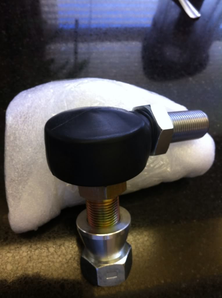

Got the new Kinetix Rod end with the new dust boot.
Thats exactly what they needed to do to make their arm the unarguable next best option to the SPL arms.
The boot and adding the Conical Seating sleeve is hat they needed.

^ yes...nice...boot and sleeve look great....
I would still say they arent better than spl...spl upper arms let you adjust caster.
but nice to know that they are still investing in their product.
for those out there with the old rod ends with no sleeve, im guessing you can probably buy the rod ends from their site.....wonder if when you do the new ends come? i know they sell them on thier site directly..
-J
