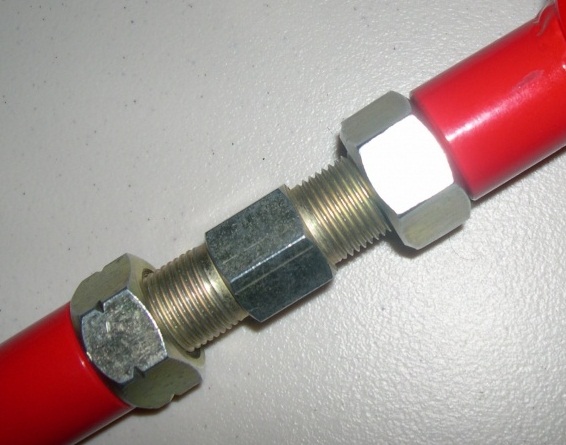

Originally Posted by Bobby@Momentum
Some companies choose to put in an adjuster with a jam nut on either end (attached picture) and while this does allow adjustment on the vehicle with minimal effort, we saw this as a sacrifice of rigidity and performance.
ya, ive seen that stuff on rear arms, etc on the Z usually, not on front upper arms...i doubt there is even room for that on the Z front upper arms common to the caster frame mounted points....

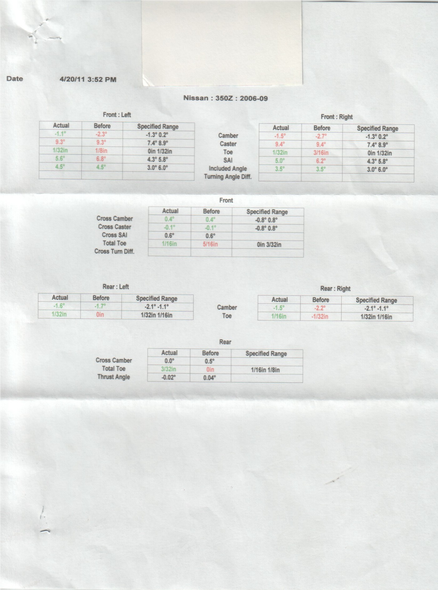

Jason when you get a moment-
I had the SPL arms installed, was running into bolts that were torqued on too tight for the tools I have. SPC's wonderful clunk is finally gone . Now Im getting it dialed in, my alignment came back with the caster high and I have some difference in camber from side to side. The specs below are with all shims in and caster was stock on the arms from SPL. My car is lowered 1.5" all around in general, except I did level it side to side vs stock(kept front to back ratio the same). I know I might need some additional shims to be able to get the camber to match made(do you still make these? ). On the caster, is this high enough to worry about driving? From your SPL DIY it looks like the rod end closest to the back of the car would be turned .2" roughly to get back to spec?
Honestly I wouldn't worry about the caster. That difference you refer to is in almost every Z i've seen and the slight out of spec shouldn't hurt a thing. Caster is only realized at significant steering lock. So the chance you will notice the additional .50 is unlikely. Everything else on the spec sheet looks good.
