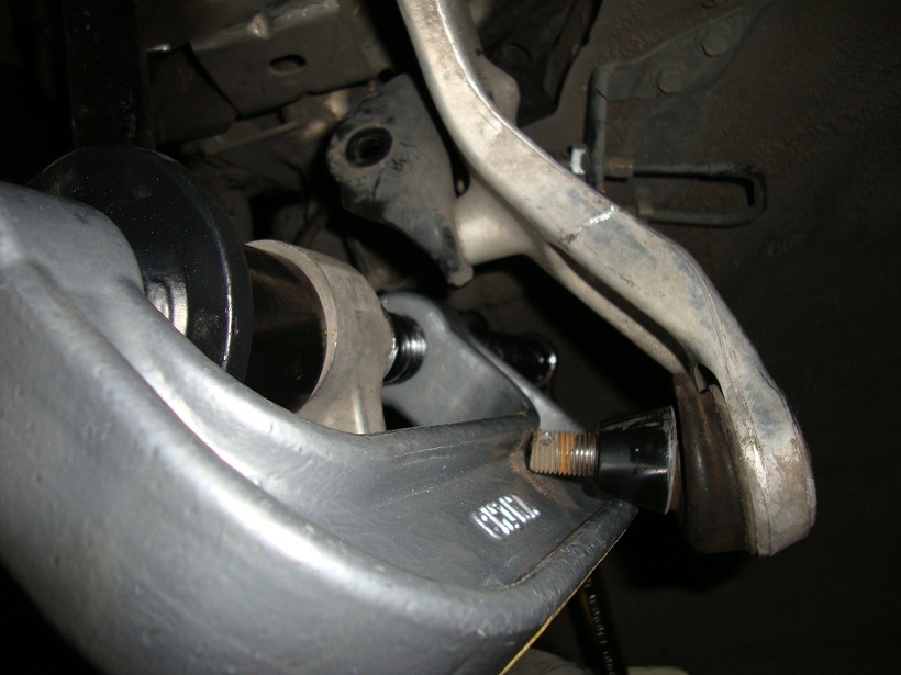

Looks like my bushing on the Translink arm is cracked. You guys think I should replace it?

If you can afford to, replace it with an SPL bushing and then be done with it.
Holy stripped bolt batman! May want to replace that while you are at it.

Yeah that nut is looking pretty graunched.

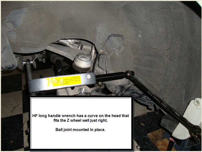

On a side note, does anyone know of a tool to press out the shock mount bushing out of the knuckle? I would prefer not to go through the ordeal of removing my rear knuckle and unfortunately I have to replace my SPL shock mount bushing.

Ball joint press from harbor freight works, large socket and all thread works too. The rest of the knuckle is a major PITA , trust me

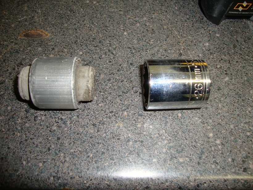

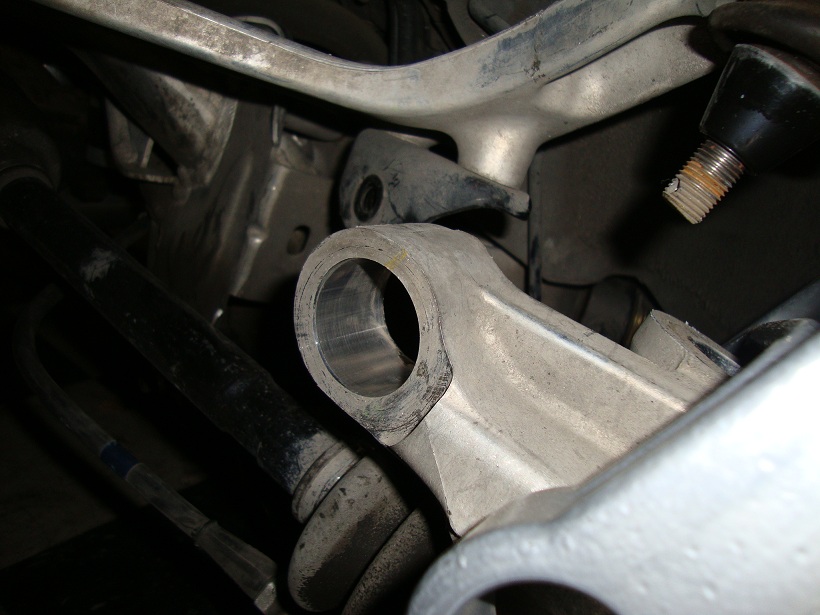

Ya, for the rear shock mount - the HF ball joint tool works just fine. I recommend using the HF long handle wrenches as well, cause the curve on the wrench lets you use it in the wheel well and have leverage with the long handle...the combo worked great.
Also, I cut a piece of DOM steel on one edge to a 5 degree angle to make it match the oem rear knuckle machined edge angle to press PERFECTLY straight!
This is when i did mine:
I used a 26MM, 12 point socket from a set I had laying around that fit perfect for pressing the oem bushing out:
OEM bushing out:
-J
